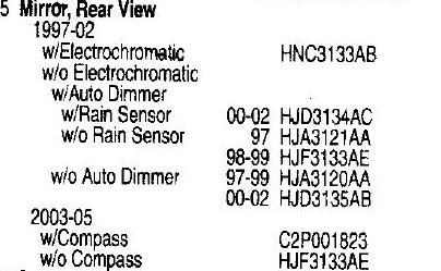

My auto-headlights are not working. The lights work in all other positions on the switch so I am reasonably sure it is the sensor in the rear view mirror. I found a mirror for sale but I am unsure if it is the correct one. The part number is xr845625agd. Any assistance with verifying that this is the ciorrect part would be appreciated. Thanks

The part number you listed is for a sunvisor with mirror. Take a look at the attached for the rear view mirror part numbers.

Thanks Brad. I finally got the right number and it was for a '98-99 w/o rain sensor. I have a 2001 with rain sesnosr. You saved me at least the shipping to return it, and the aggravation of buying the wrong part. I will be moving to Port Charlotte in August. Maybe we'll need to do a cruise together. Ciao
