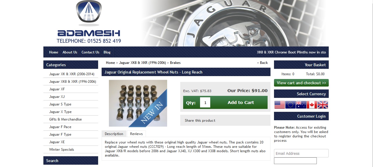

www.adamesh.co.uk/jaguar-original-replacement-wheel-nuts---long-reach-4856-p.asp
We call them Wheel Nuts which is possibly why your search didn't find them.

I think the Adamesh nuts are too expensive and flawed. As per Steve's information, I think these could fit in theory. These are Mag type ½ x 20. Thus, they have a barrel and a shank, which means they should be usable with the space saver spare. Could anyone confirm that these are the right size?

Adamesh also do solid nuts https://www.adamesh.co.uk/replacemen...els-1080-p.asp for some reason they are about half the price of the OE nuts.
"Upgrade or replace your damaged wheel nuts with these high quality solid head 1/2 inch flat seat nuts.
No more annoying stainless steel caps coming off when you least expect it (probably when you have a puncture!)
Supplied in a complete set of 20 wheel nuts or in a set of 16 wheel nuts and a set of high quality locking wheel nuts to prevent your wheels from theft.
Suitable for all XJS, XJ40, XJ6, XJ8, XJR models before 2004 & XK8/R models before 2006.
Not suitable for Jaguar Asteroids 18" wheels - see original Jaguar nuts"
The lug nut guys nuts look to have a longer shank.
