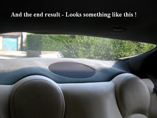

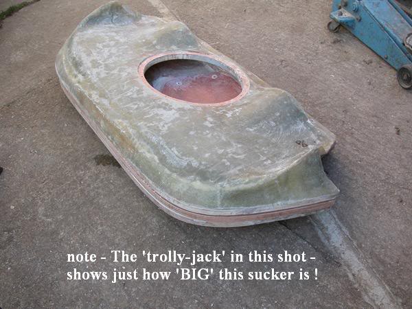

I don't much rate free air subs, but they do fit a purpose if you don't want a large box taking up most of the trunk space.
Then again you could always make one of these
And once fitted
