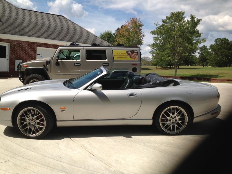

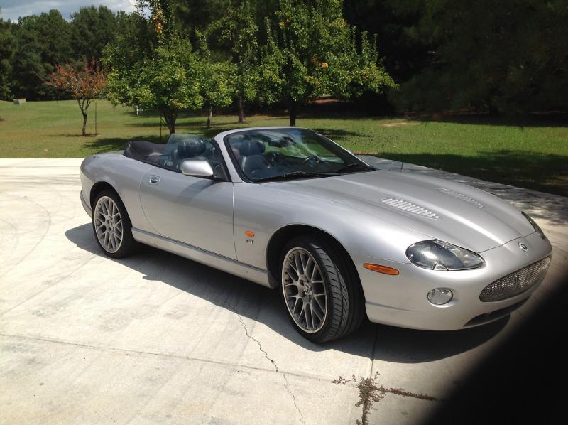

For some reason my long reply didnt post. Basically I changed the oil and used a Jag filer. The noise on start up stopped. However, I still have a knock on idle and a quick short rapid clicking on fast deceleration when supercharger is engaged.
I uploaded 3 pics also
