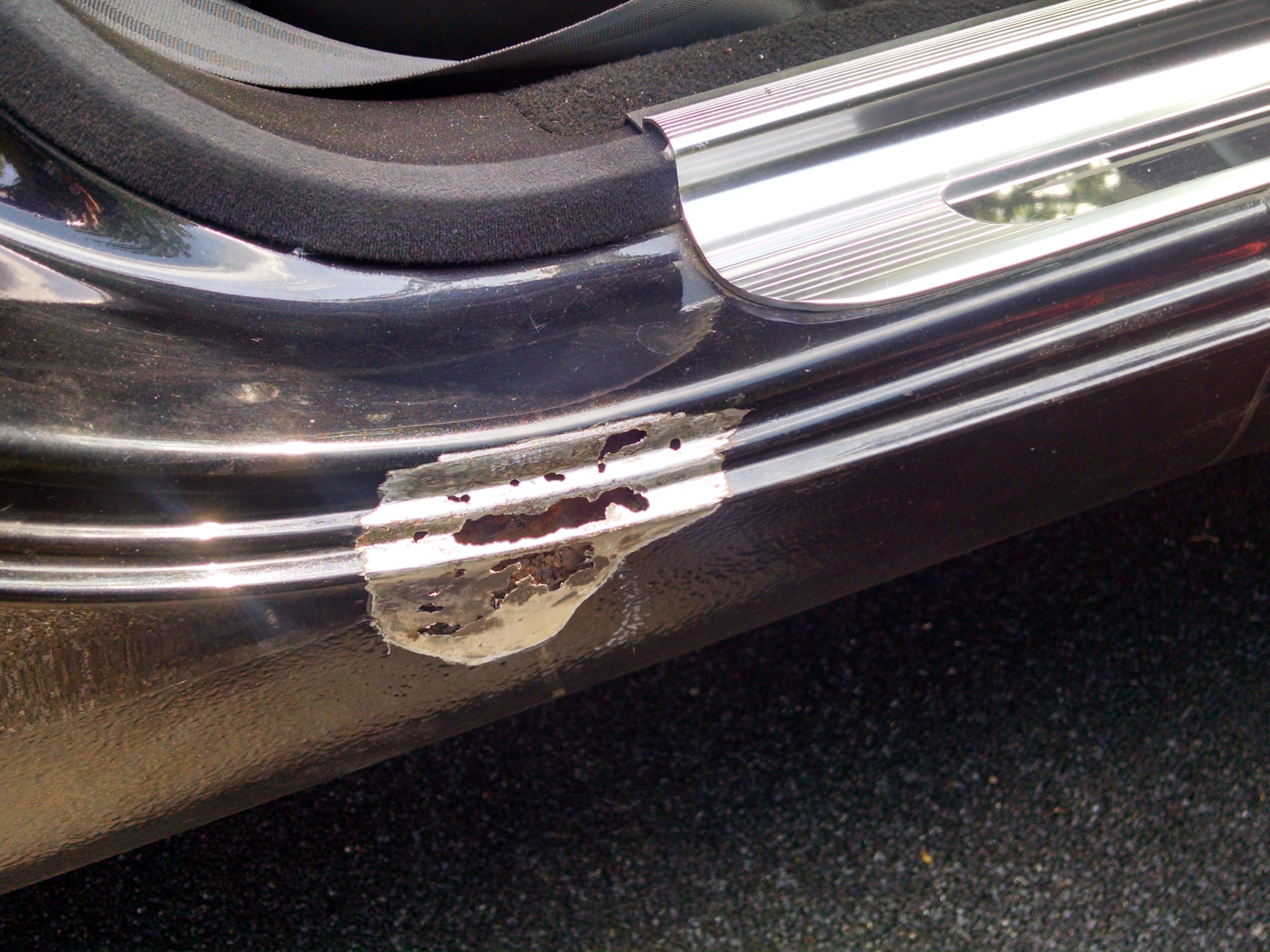

I reserved a couple of hours to do a touch-up on a small rust spot below the passenger door. Well now, wasn’t THAT optimistic!
On the first paint removing poke, the punch I was using to chip with went right through the rocker panel. It wasn’t surface rust - the car was rusting from the inside out! (….groan). After just a few moments I realized it was time for the dremel. Those of you who’ve played with this scenario know that no matter how much it hurts, you just keep sanding until ALL the rust and blackened steel is exposed. Here some pics of what was revealed. Ouch! So a two hour task turned into a two day project, with prep work, bondo and intial sanding on the first; and finishing bondo, sanding and three layers (many coats) of paint on the second. The results are clearly amateurish up close, but at least I know that I’ve delayed further corrosion for a little while, and I don’t have to look at that tiny, annoying rust spot anymore when helping some sweet pretty lady into and out of the car.
Something I found curious was that the rocker panel area seemed to be filled with what almost looked like sand, yet I could find no entry point for it. After removing as much metal as I could and busting up all the junk inside the rocker, I vacuumed and blew out as much of the junk as possible. Then I saturated all of the inside I could get to with rubberized, corrosion inhibiting paint. I sure hope that makes a difference.
Of course, I DRIVE my car. Kitty's rapidly approaching 195K miles. So, despite the build quality of these cars (quite good in my opinion), I guess having some routine evidence of her aging isn't to be totally unexpected. I'll have a body shop pretty-up my work some day in the future.

I've seen perforations around door closures due to water getting trapped by the door seal, but that looks to go much lower down. From what I understand the rear wing is only bonded to the inner arch: the bond fails allowing water and mud to get in where it never dries.
I believe that it's double-skinned there and not reachable from the 'bung' in the rear wheel well. I'm wondering if it's possible to get between the skins from inside by removing the rear side panel. I never thought to check when I had the interior apart to replace the headlining.
TBH I think the build quality is patchy at best given these are high-end cars. There's a lot of out-of-sight metal that's only got a thin paint coating (like inside the front wing).
If they use salt on your roads then it's only a matter of time
I do hope it turns out to be localised..

Thanks Mike. That's an interesting idea. I should check the fender well. I only searched beneath and in front of the rot looking for a point of entry. You're right - it could have been building up from behind and above. I'll give a good look-see next time I have her on the lift. Maybe I can remove the fender liner for a good cleaning and treatment.

All NA MX-5 Miata's rust there, too. Even Texas cars. Water & salts get into the rockers from the rear wheel wells and top drains.

The convertible has an additional tubular strengthening "beam" which runs from front to rear - you can see the ends in the wheelarches.
On all cars, from the front wheelarch to the centre of the car, there's a single steel skin BUT from the weld, about half way along under the door - it is double skinned. The weld is just visible to the extreme left of Scardini1's second photograph.
From here to the rear, there's a small gap tapering from 0mm at the weld to about 10mm at the front of the rear wheelarch. Here, there's no weld, just sealing compound which, over the years, loses flexibility and therefor adhesion between the two steel "layers". It's a perfect place for mud and water to collect and do their worst.
There's a guy here in the UK who makes replacement outer skins for that area from the weld to the rear wheelarch so there's a solution this side of the pond. Probably less common in the US where rust doesn't seem to be quite such a problem as here in the wet and cold (and salty road) UK climate !
