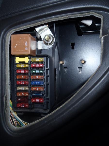

Have you checked the inertia switch? Its on the left hand side when you open the door there where the fuses are located.
Ah! Excellent point! If the car was in a front end collision it is very likely that the inertia switch was tripped. It stops the flow of fuel so that there would be less likelihood of a fire.
This thread might help you locate your inertia switch.
https://www.jaguarforums.com/forum/x...-advise-47463/
Can anyone tell Samantha how to reset it if it is tripped?

Sorry should have added. On top is a button, yes press it in, and it will be deactivated (so ok).

Apparently it's in a different location on the 2003 and newer cars because I just looked at mine, and it isn't in the fuse compartment.

I think all steel bodied XKs have it in the same spot, are you looking in the right place?. Here is a picture, the black arrow shows the unit, and the red arrow shows where you need to push.
Can try to make a video of it ;-)

My car has nothing there. WJD said the same think about his car in the other thread.

That’s odd/interesting; JTIS also mentions it is in that spot for a 2003 MY (but that one can be wrong). In the electrical diagrams (which is usually correct as far as I know), it is mentioned for your model year (and all older ones) to be “ADJACENT TO LH FASCIA FUSE BOX”.

If I recall correctly it is not at the fuse fox it is below and you need to remove the left hand kick panel, the one that is behind the hood release.
Nope... not there. That's the same problem the guy was having in the other thread. Everyone was saying it's right there, but it wasn't. Fortunately I'm not having a problem with mine.
