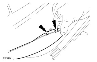

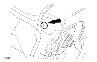

  1. Using rear passenger access knob, release the seat back and move it to the fully forward position.
  2. Remove rear access knob and escutcheon.
    1.
      • With a small flat bladed screwdriver, ease open the knob stem to clear the seat lever tang and remove the knob.
      • Carefully ease knob escutcheon from two studs.
      • Slacken and remove two screws.
  3. Slacken and remove the two screws securing the lower section of the seat back finisher to the frame.
  4. Withdraw the trim and 32 clips from seat back finisher and position trim for access.
  5. Remove seat back finisher from seat..
INSTALLATION
  1. Align and fit back finisher to front seat.
  2. Reposition back finisher trim and secure with the 32 clips.
  3. Fit and tighten the two screws securing the lower section of the back finisher to the seat.
  4. Fit escutcheon and rear passenger access knob and return seat back to the upright position.
