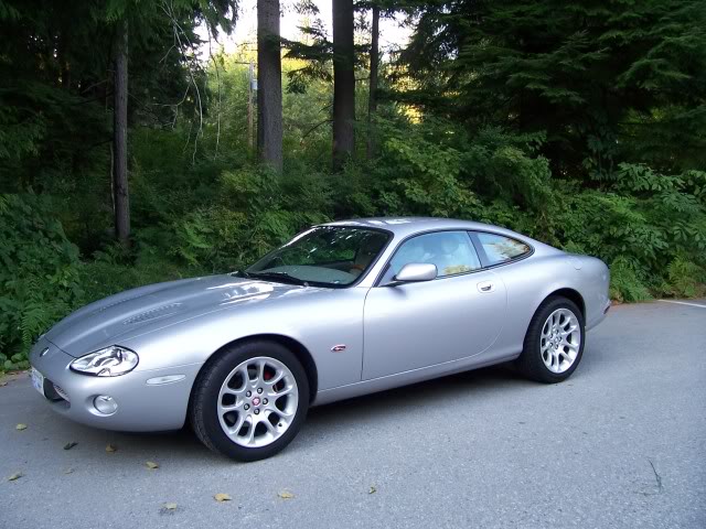

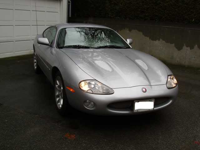

Most of the time, no. I removed the side molding on my car (using an old credit card to "cut" the foam of the double sided tape, and then a 3m auto adhesive removed to get the residual double sided tape off - see link in my signature) and I had only a slight difference in shade which was fixed by buffing the area with a random orbital buffer and a light cut compound.
However, if your car has been in a side accident it's probable the repair shop didn't bother removing the molding and sprayed over it. In that case, if you remove it you will find a noticeable difference in shades (as was the case with my truck). Your car would have to be repainted.
Also, if your car has spent most of it's life outside in a sunny region then it's possible the paint has faded slightly, while being protected underneath the molding - hence if you remove the trim you might notice a shade of difference.
All that said, it's one of the best "mods" on the XK in my opinion, and the car looks a 100% better and more modern in my opinion. It is also completely reversible, as the molding is flexible and doesn't get damaged if you take care during the removal, and thus can be reinstalled back later if so desired.
Before:

After:
