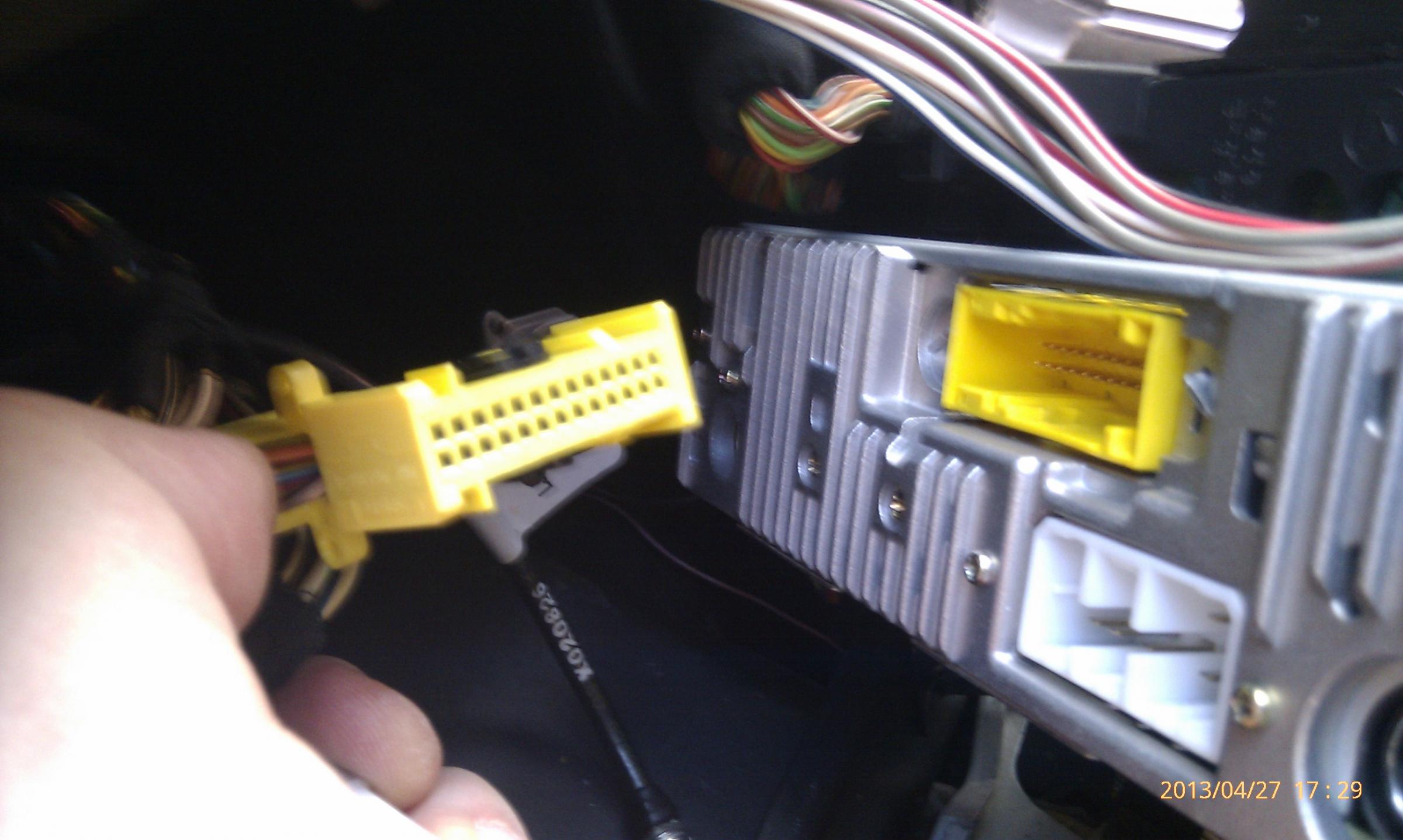

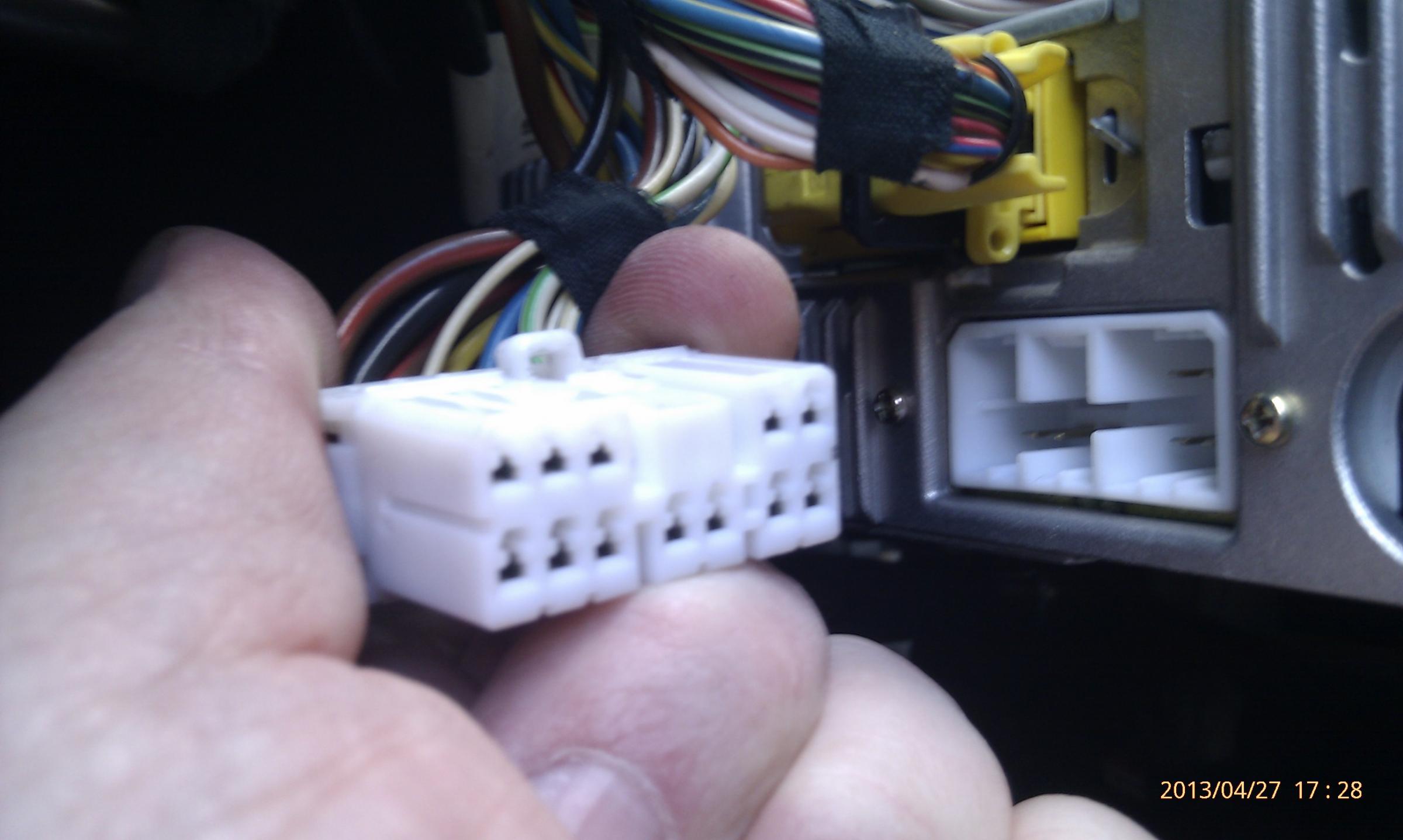

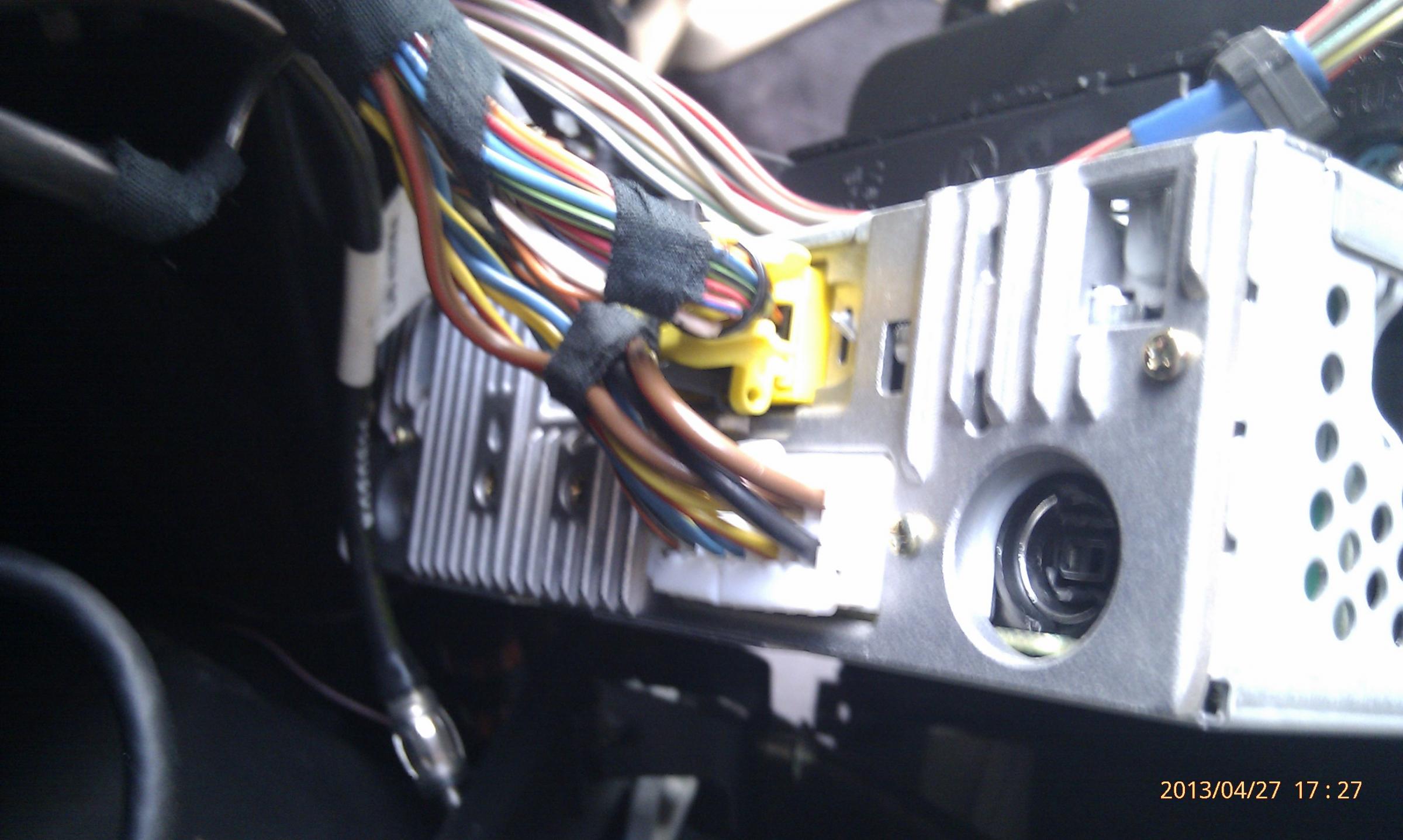

A while back I had a look behind the head unit and took some photos. Thought I'd post them here for reference. Be sure to have your security codes handy if you do take the connectors out as otherwise you won't be able to use the system. In the first picture I've taken the antenna plug out (hangin in theleft) and the CD changer Ai-Net plug (the round socket on the right).
