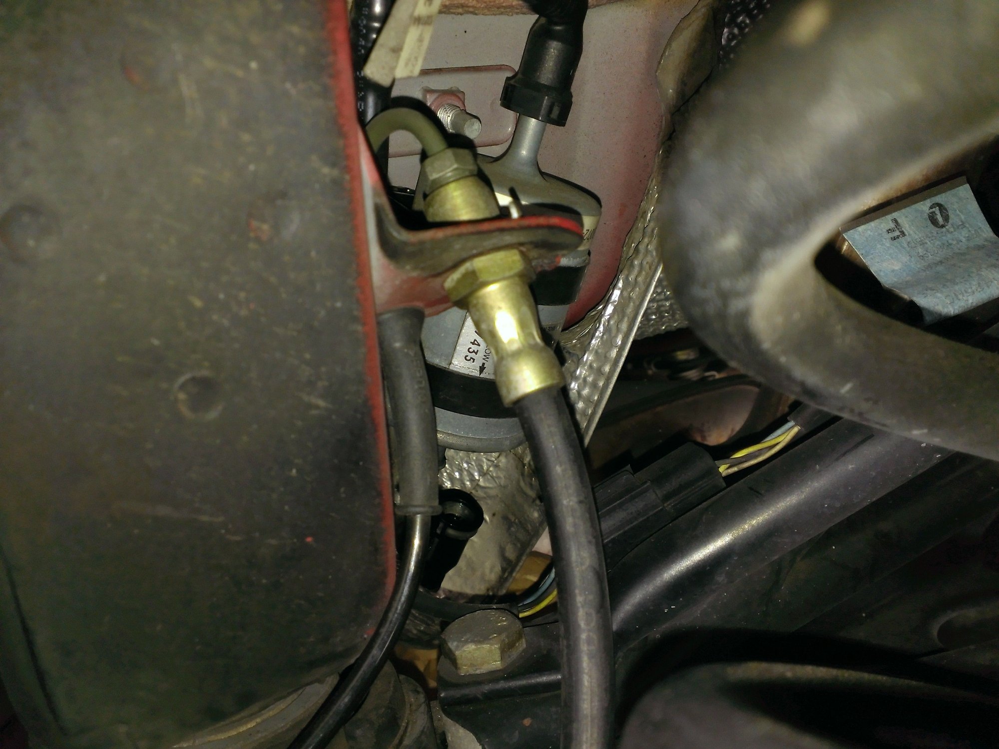

rothwell's Avatar
Joined: Jan 2009
Posts: 2,199
Likes: 1,371
From: Hudson, Florida
Thinking...where oh where could I get an easy opening that a fuel pump could then do the work...maybe?.
Old Mar 16, 2026 | 06:41 PM
motorcarman's Avatar
Posts: 13,758
Likes: 9,713
From: Wise County,TX
The 4.2 liter cars are very different.
The 4 liter cars have a filter near the rear suspension.
The easier place is the engine at the fuel rail for pump to deliver fuel to a container via plastic/rubber hose.
Old Mar 16, 2026 | 08:08 PM
rothwell's Avatar
Joined: Jan 2009
Posts: 2,199
Likes: 1,371
That pic was of my 2004 4.2L N/A perhaps the 4.2L S/C are different?
