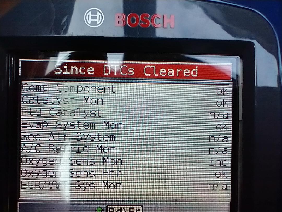

I connected my OBD to read codes. I found this page. Is this what needs to read OK for it pass the SMOG? All of them (California, yr 2002)?

According to your scanner, you have one monitor that has not yet cleared and reset (oxygen sensor). My understanding of the California emissions law is that you are allowed one monitor to still be incomplete in order to pass the requirements. Our emissions law here in North Carolina also allows for one incomplete monitor. You should be good to go now....
