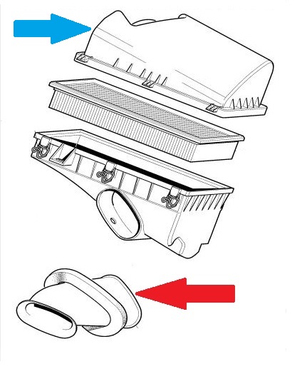

A disconnected Air Intake (arrowed in red) would make little difference but a leak from an open Aircleaner box lid (arrowed in blue) could weaken the mixture by pulling unrestricted air instead of drawing it through the filter element.
A more regular scenario is a break in the inlet trunk between the MAF and the Throttle Body which causes chaos with the fuel trims.
Check for splits in the convoluted section of the trunk.

Graham has you covered but I'll add, Very odd the top would come off there are 4-5 latches holding it on. The air intake came out because the box was moving about ensure you have the rubber mounting connected and the rubber isn't broken (hence it holds nothing) you can get knock offs for $5.
Hopefully it didn't bounce too much the elbows to the TB would have been flapping and they are known to wear through but if they did you know soon enough.
