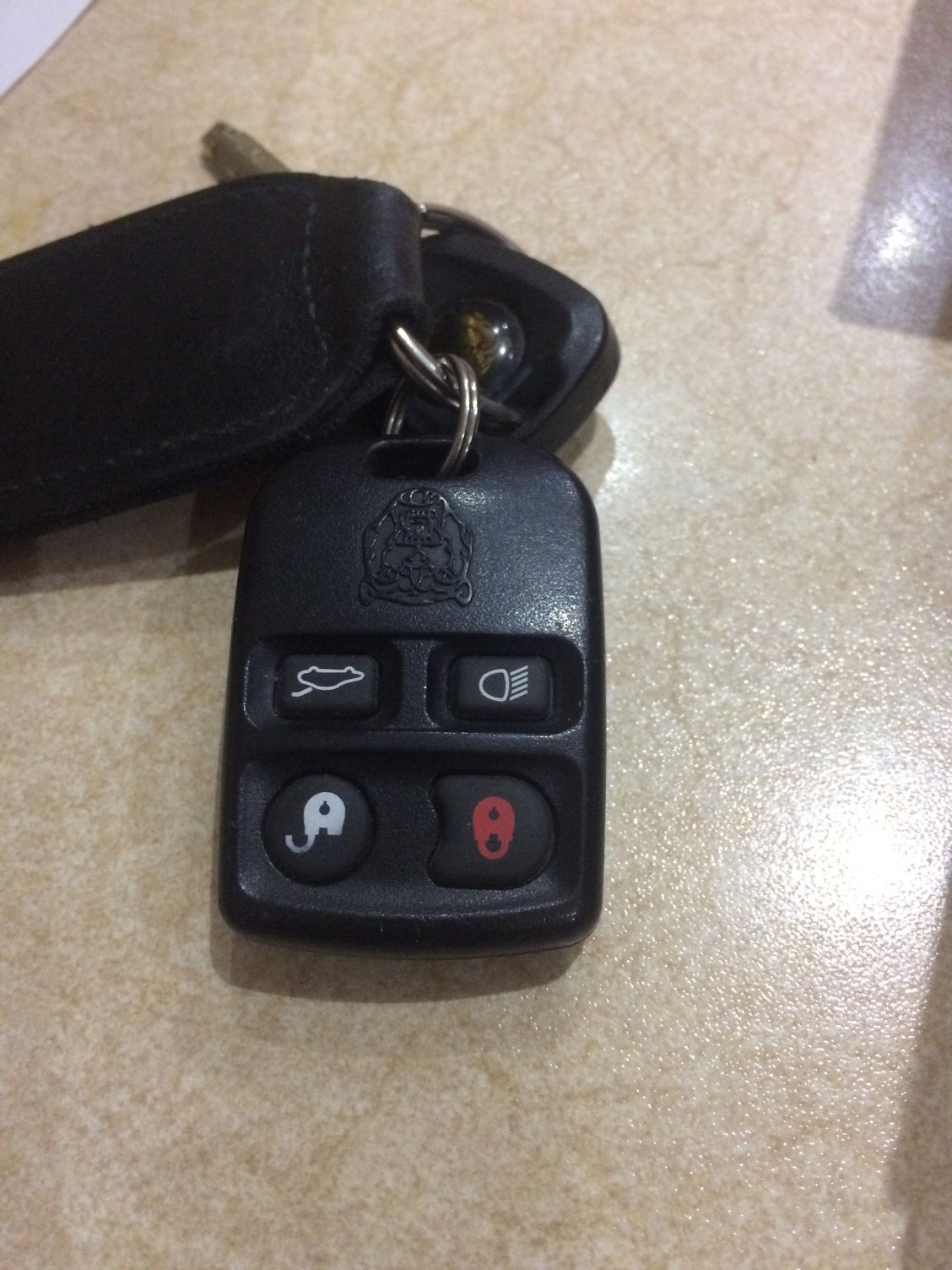

Old Feb 13, 2017 | 02:51 PM
Chalgravesteve's Avatar
Joined: Feb 2017
Posts: 108
Likes: 12
Old Feb 13, 2017 | 04:09 PM
Ungn's Avatar
Joined: Jan 2016
Posts: 1,177
Likes: 375
From: Southlake, TX
FOB's with the O shaped open and D shaped lock buttons are "ford compatible".
Read the FCC number on the back and type it into an E-bay search to see your options.
It took me forever to learn to program my FOB's, but now its easy. My mistake was I was turning the key to "run" instead of just "accessory". That and extra the remote I bought had the wrong battery in it - too thin.

Old Feb 17, 2017 | 06:41 AM
Joined: Feb 2017
Posts: 108
Likes: 12
Ok an update.
My "new" fob arrived. A used one off eBay. Right path number. Good start.
Prepared 6 chickens for potential sacrificial offering.
got in car with existing remote and key.
Put the turn ievet up (as though turning right) and pull the lever at the same time into the flash position and hold it there.
Turn ignition key to 1st position (accessories)
flash the lights 4/5 times in 3/4 seconds whilst keeping lever up in the turn right position.
I wss was rewarded with a red light from the centre console next to the gear stick. Press the 4 fob buttons in turn and each press caused a red light at the gear stick!
Switch off ignition get out of car. Check new fob is working. YES!!
5 minute job! Try to lock car with the original fob. DOESNT WORK!
Bugger.
So, back in the car. Same sequence. Press the buttons on the original remote. It works again! The new used one doesn't though! The penny drops, I sacrifice a chicken for good measure and then go through the sequence again and press the fob buttons on both fobs whilst I've got the programming live.
YES!!!! Both fobs work! Go back into house, having locked the car up, to put the spare key on a key ring with the new fob. How did I manage to do that???
hanging on the spare key ring is a remote fob, not a second key!! I needed a key not a bloody fob! So I then had to get back in the car, and go through the whole sequence again as the 3rd fob didn't work anymore. I now have three working remote fobs and one key !! I can only assume that getting a spare key (2 now!) will be simple but where can I get a blank with the jag logo on it?
