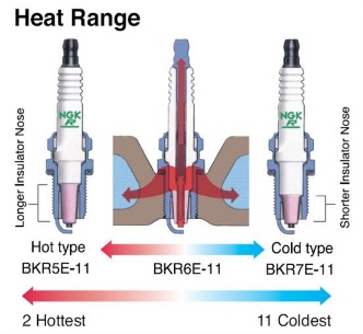

The development from Platinum - Laser - Laser Iridium was claimed by NKG to be for longer service life.
The recommended plugs are to match Jaguar's specification and the variable here has to be heat range.
The balance is between the tip being hot enough to 'self clean' but cool enough to avoid 'pinking' (pre-ignition).
Presumably the precise engine mapping over the years was matched to available plug technology at the time .......

Yes Graham, when I spoke the the person at the technical dept she said it was all to do with heat distribution.
There must have been some other developments from Jaguar between my car and the next update to resolve those issues, as you say may have been in the ECU or firmware as its the same AJ27 engine everywhere else.
