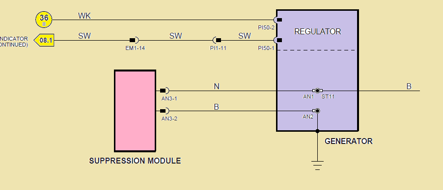

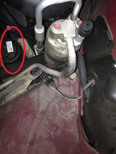

Msterieus,
What you have described sounds like classic alternator whine, which is much more likely to be a result of poor suppression/bad grounding, as Lady P suggests, rather than a 'dying' amp and should be a straightforward troubleshoot for any audio tech worth his salt.
The 98 has a 'suppression module' above the alternator (circled in attachment, courtesy of MadBrad). Check if that has been disconnected - or removed.
Simple checks first before spending $$$.
Mike

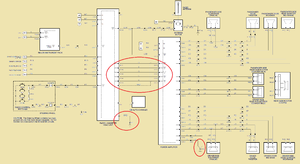

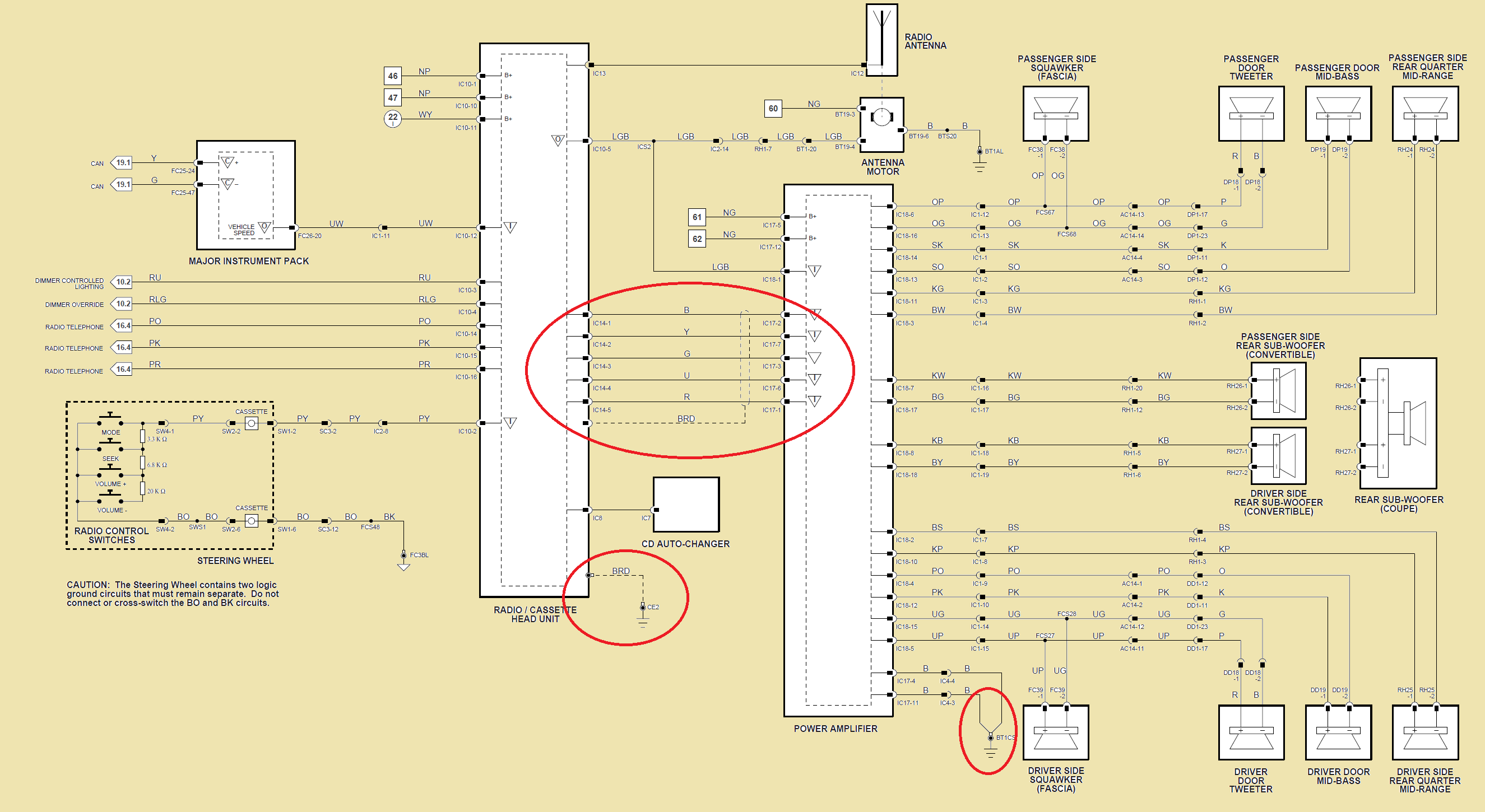

Sorry - don't want to contradict, but I'm not sure all of the above is true.
On the "basic" system, there is no separate amplifier. The head unit contains all the circuitry to take inputs from radio, Cassette and CD player, and sends the output to four speakers.
On the "premium" system, the (same) head unit sends a low-level audio signal to the amplifier in the trunk/boot which has four-way active crossover circuits which drive ten separate speakers (nine in the coupe).
First thing I would check is the suppression module :
https://www.ebay.co.uk/itm/JAGUAR-AL...-/222596790036
If this is disconnected or faulty, it may lead to the symptoms you describe.
Any amp will not necessarily work, even with the correct connectors.
Do you have the little triangular "tweeters" on the inside of the car where the door mirrors are ? That will show whether or not you have the "standard" or "premium" system, and we can take it from there.
Edit : was writing while Mike was posting !!

The black wire on the suppressor goes to ground and may have been disturbed during alternator change . Or it's grounding point may be corroded or dirty .
