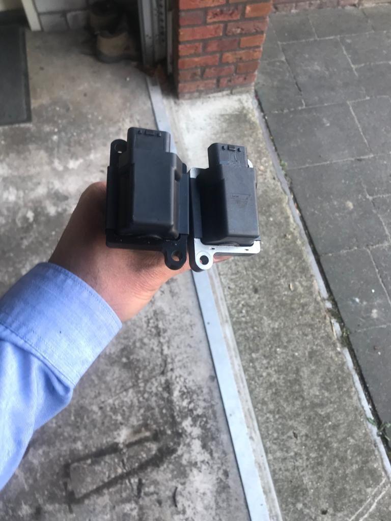

Originally Posted by Jon89
Various types of aftermarket coils have created many issues on these cars over many years. If you decide to go with aftermarket coils, always post what you are considering here on the forum prior to purchasing them. There is safety in numbers and you want to ensure that others have had good experiences with said coils before you commit to them....
+1 on not buying cheap *** China coils (as I did&#128563
I got 8 useless coil packs and even paid import tax for it😱.
Picture: mirrored manufacturing.. (&#129315​​​​​​​
