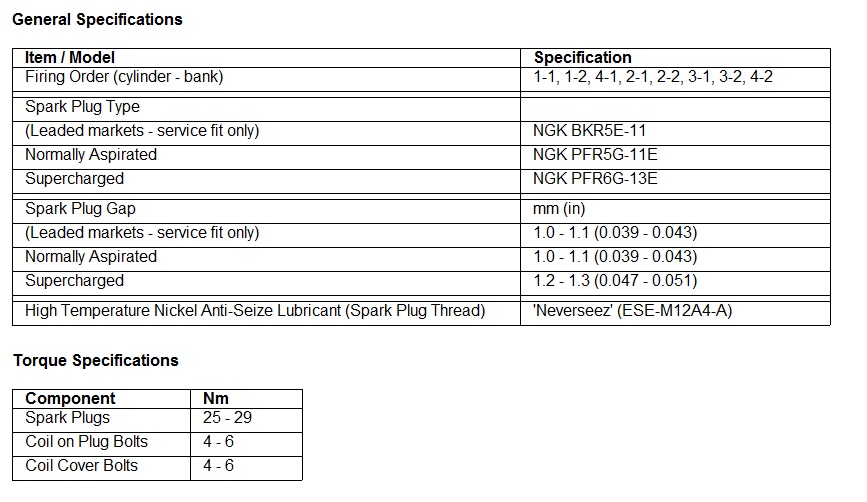

Probably too late.......JTIS sez NGK PFR5G-11E torqued 25-29Nm.
Old Mar 4, 2013 | 03:03 PM
Originally Posted by Lanny
............ So I went to the owners handbook to see what the factory recommends, and found nothing. I guess in the proper world of JAG you call "your man" to deliver the car to a proper garage and make it all well. ............
Spark Plug recommendations are buried in the Vehicle Care Handbook but detailed in JTIS. It's in Powertrain - Engine Ignition - Specification section:

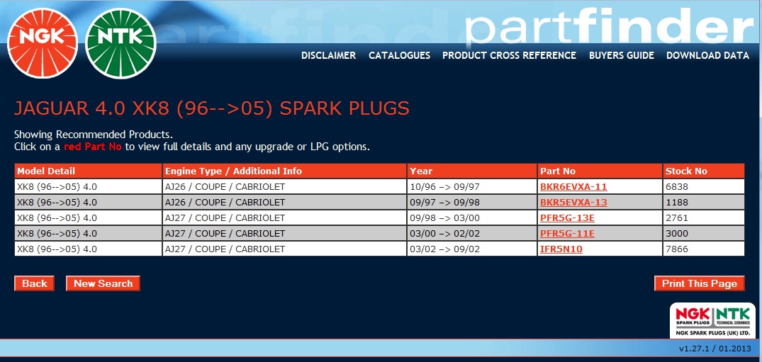

Spark Plug codes are a minefield!
Here's an extract from the NGK Part Finder:

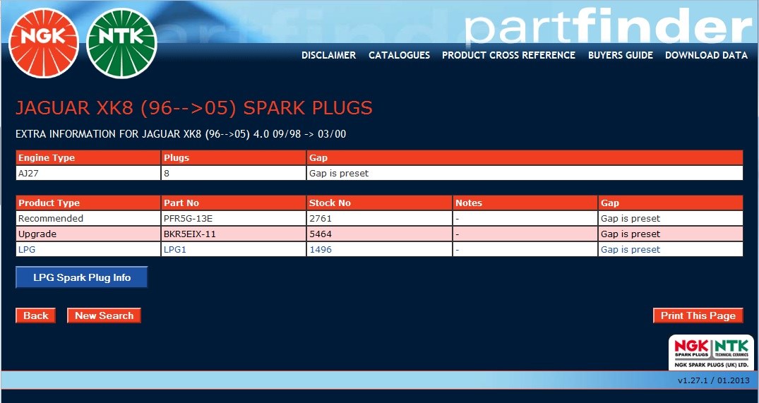

This shows the correct Spark Plug for your vehicle is PFR5G-13E. However this has been superseded by an upgrade:
The upgrade is BKR5EIX-11. This is the number Amazon had shown you was not right for your car. I can't find a direct Bosch equivalent for this plug.
