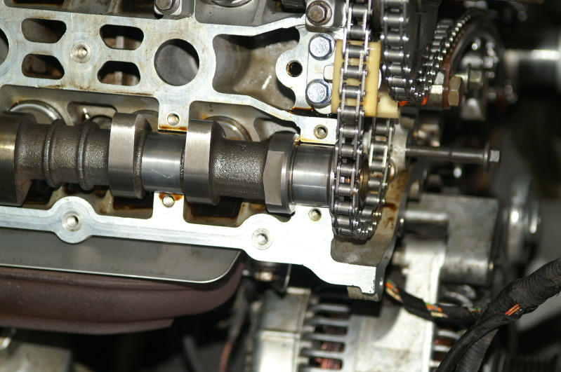

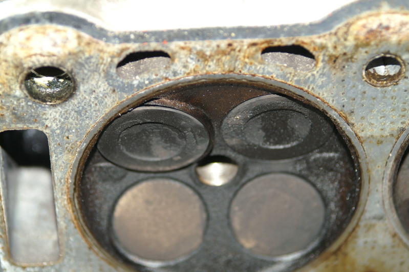

I've got no useful pictures of the valves in any that i took, as the valves are covered by the camshafts.
From what i can tell the lobe pushes down on the top of the valve and as the lobe passes the valve, the valve springs back up.

You have the valve which has the spring on it, on top of that is what most call the bucket, technical term is the valve cap but that gives the inference it is small, it's 35mm in diameter. Set in to the bucket/cap is a shim which runs on the lobe of the cam... It is the bucket that moves up and down with the valve
Now i know what i'm playing with. The bucket is the round shield on top of the valve, and RJ237 has pre-empted my next question about how to measure the clearance.

I had trouble getting my fingers on the buckets to rotate them, because the cams were in the way.
Also they are smooth surfaced, and although i tried with some of them, i couldn't really tell if they were moving, or if my fingers were just sliding across the surface.
I guess i could mark them with a felt pen, and try to move them with something soft and grippy to see if they turn.
I'll try again tomorrow, weather permitting.
Regarding the misfire, as i said earlier in the thread, it doesn't seem to be misfiring, it's running on all 8 pots and the inlet/exhaust timing is ok.
It's just that noise.
I will check the plugs tomorrow as well though, to see if there's any discolouring of a plug.

Your posts #35 + 36 show exactly what I was worrying about - a displaced valve seat but in the wrong direction - that would INCREASE the clearance.
Hi Roadhogg,
from the video of the car ruuning, I though the engine sounded irregular, that is why I think it could be valve related and why I think a missfire exists.
it is a little strange that on the cyl where the noise MIGHT be coming from, it has reduced clearences. why ?.
is it possible to have a valve that will not close properly, and leave a gap between the valve and the bucket.. ?. this could create the noise you hear.
This is why you need specific advice now from a person who has worked on the valves from this engine. If it was my car, id do exactly what you are doing and ask the questions on the forum.
Incidently when you did the timing, was it out at all, when you originally checked the timing before starting work on it ?.
Please bear in mind it might not be valve related at all, but what else could it be, I cant think of anything from that area of the engine.
