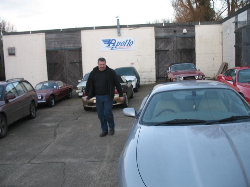

Well, she made it to Tony's, but not without incident.
Gearbox fault came up on the text display as i was leaving London in the morning, and although i'd known since shortly after buying the car a year ago, that the gearbox had a slow leak, this was the first appearance of that message, and the resulting limp mode for the gearbox.
It just meant several stops on the way to let her cool down.
Tony was the perfect gentleman, and i spent a couple of hours chatting to him.
She's in safe hands now

Oh thats a really bad pic lmao!!! very windy too!!

Well you didn't say 'cheese' did you.
(Truth is i caught him unawares )

Tony was the perfect gentleman, and i spent a couple of hours chatting to him. She's in safe hands now
Ah, so there's a snap of our beloved Tony Murton, The King of the XK. What an asset he has been to this forum, and to me personally with my own car. Nice to see the man in person.
I will say, however, that if my car were in his shop, I would be compelled to go for every trick in his book. Which would of course require that I sell my house and live in a box. But my coupe would be something to behold.
