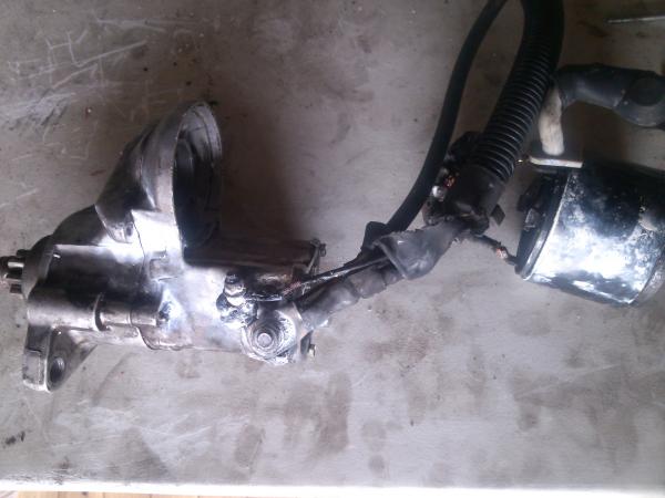

SO- I waliked out to the XK8 yesterday afternoon and smelled electrical burning- after disconnecting the battery, I looked around for damage and smell.
I found that the connectors from the car to the starter had melted the plastic insulation completely off and had to replace the starter. So random.
I cannot figure out why that may have happened, except that possibly the plastic had cracked, and arcing began ultimately melting the whole thing?
I HOPE that was what happened and that I do not have a different issue that will rear it's ugly head again...

That earth connection looks badly corroded from here. This sort of thing isn't unheard-of - connections corrode and go bad, current and heat shoots up, stuff melts.
