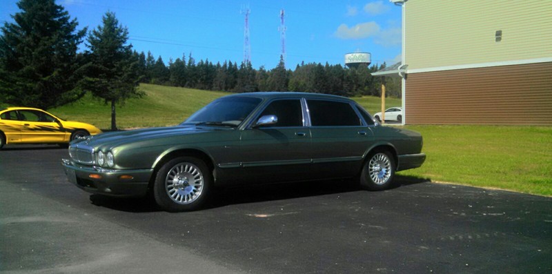

PS: Hard to truly capture the colour in the light, but here is the new (second time's the charm!) paintjob and wheels (Wheels are 96 VDP wheels, stripped and polished aluminum)
