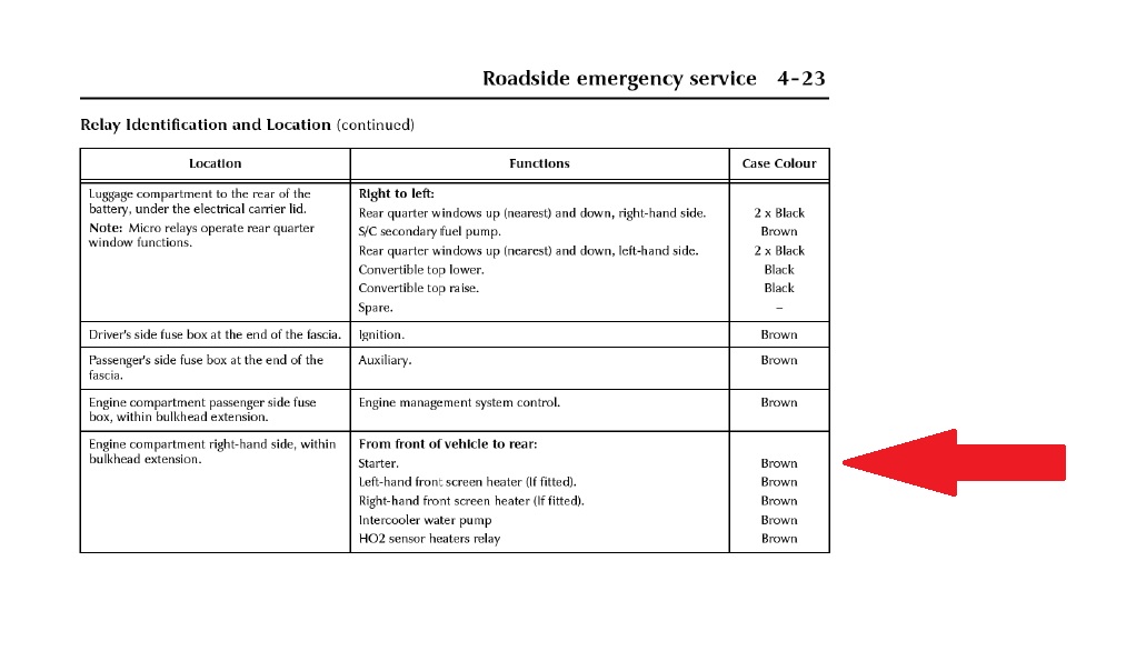

Will the starter solenoid be mounted on the starter? Where will I find the starter relay?Do you think I might be able to squirt some electronic's cleaner into the area of the shifter in the hope of cleaning the contacts of the Park/Neutral switch? Thanks for the troubleshooting direction...

Originally Posted by Bob OB
............... Where will I find the starter relay?...
Fuse and Relay information is in the Vehicle Care Handbook. If you haven't got this or any of the other Handbooks for your vehicle, they can be downloaded in PDF format by following this link:
https://www.jaguarforums.com/forum/x...-2003-a-67827/

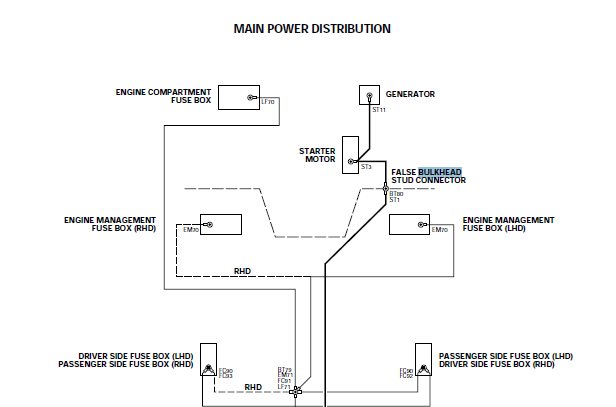

Yup. Cleaned and retightened. You mean the junction in the boot /trunk,right?
Bulkhead connector is under the hood; It's where the high power lead enters the engine compartment; I use it to connect my battery charger during hibernation; It's well concealed, here's athread that might help: https://www.jaguarforums.com/forum/x...nnector-92454/
And maybe attached diagram will help you find it
