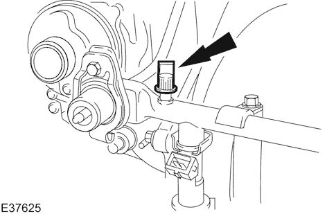

JTIS Shows the Fuel Pressure Port at the back end of the Right Side Fuel Rail (on XK8s):
Harbor Freight has a Low Priced Fuel Pressure Tester:
Fuel Pressure Tester & Fuel Injection Pump Tester

The Schrader valve( fuel pressure port), I read is in front of the driver side valve cover. Do I have to remove a cover to get to it to find the valve and pressure test it?

The valve is on the passenger side (US) near the rear of the engine. Pull off the plastic engine cover and it's right there on top of the fuel rail. There is another one back near the firewall that is the AC charge port. I believe you should get about 40psi without looking it up.
