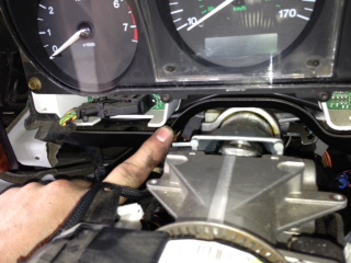

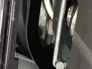

Hi all,
I managed to remove the reach motor, took a bit of encouragement but it's out along with a nut and a bearing race that fell out! Good news is my reach motor cable is intact.
Really feel the need to drop the column down to have a look at where the nut and bearing came from, but cannot get to the two allen head bolts under instrument cluster. Have attached two pics, you can see there is a metal bracket right in front and in the way of the two bolts I want to get at! I have a reciprocating saw, but don't think that'll be a good move.
Has anyone dropped the column on a '03 XK8, and does anyone have any tips/instructions to perform this task in a way that it'll go back together again and look good!
Thank you

Default Got it!
Did some poking around and a guy suggested getting the bolts from behind. Undid the brackets holding on wiring connections and then lots room for 13mm socket, undid those two plus two on bottom bracket and bolt at u-joint and presto column comes out!
Reach motor cable intact, I have the dreaded stripped thread in the nylon/plastic thing that attaches to the column and moves it in & out when the motor spins. Have heard a new column is in order, however the piece has two screws holding it on so maybe replaceable!
