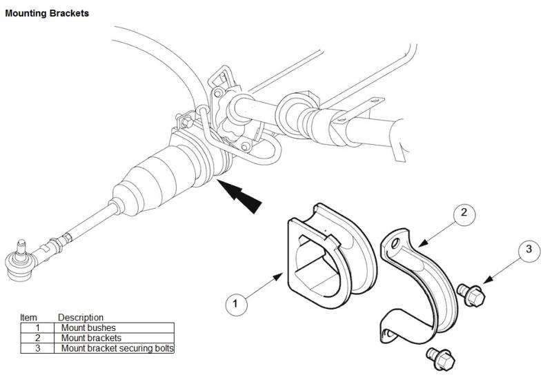

Wear in the track rods is not unknown in XK8's and there have been occasional reports of it on the forum but usually on considerably older models than yours.
The mounting brackets sometimes catch out testers because there is a very small amount of lateral movement:
However, the observation has been made by a qualified tester and my reaction would be to go over the steering and front suspension to be certain. As Jag13cat wrote in post #2, it could mean many things.
