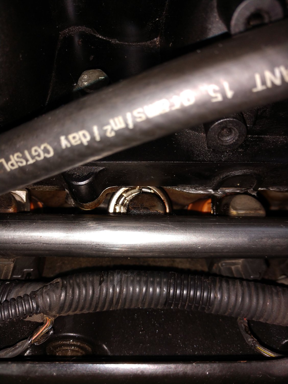

Looks like you were dead on with your guidance; the damper on the fuel rail on the driver's side has a very slow leak (a drip every 30 seconds or so at idle). You stated somewhere that these aren't available anymore as a Jag part, I was wondering if it might be a Ford item?
In the meantime I'll start working on finding either a part or can it be plugged with a screw?
Suggestions are welcome.

The XK8 is far less congested in this area than on the XKR so what I was able to do was to use some soft jaw pliers to pull the damper up into the mounting hole using the fule rail to pull against as I closed the jaws. There is a small shoulder on the mounting that it looks like the tines on the damper need to grip. Once the tines were above the shoulder I called it good. Since then the smell has gone away. To your point of possibly damaging the o-ring, if you used silicone lube on this prior to mounting I would imagine all will be well if you try the same approach. Nothing to loose I'd say.
