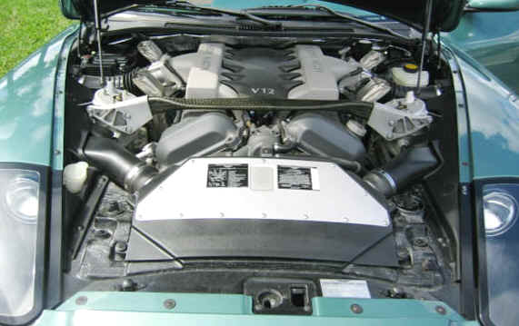

I stumbled on this photo of an '02 Aston Martin Vanquish, and reaffirmed my ability to reinvent the wheel.
That sure looks like a carbon fibre strut tower brace to me: I had asked the guy who is making C.F. ashtray lids about the suitability of the material for this application, and there is the answer. My thought was a larger assembly that also ties into the cowl, but even a simple fabrication like the one pictured would help to stiffen any XK, and might even reduce the cowl shake that Gordo has correctly identified in his convertible.
If nobody is making these for Xk's yet, and I have never read of one, they should. Thoughts?

Would the one from an Aston fit the XK? Isn't the body style the same or "pretty close"?

Valid point, it's hard to tell with the V12 tucked in there. I thought they were built on the same floorpan... it might be a direct fit.

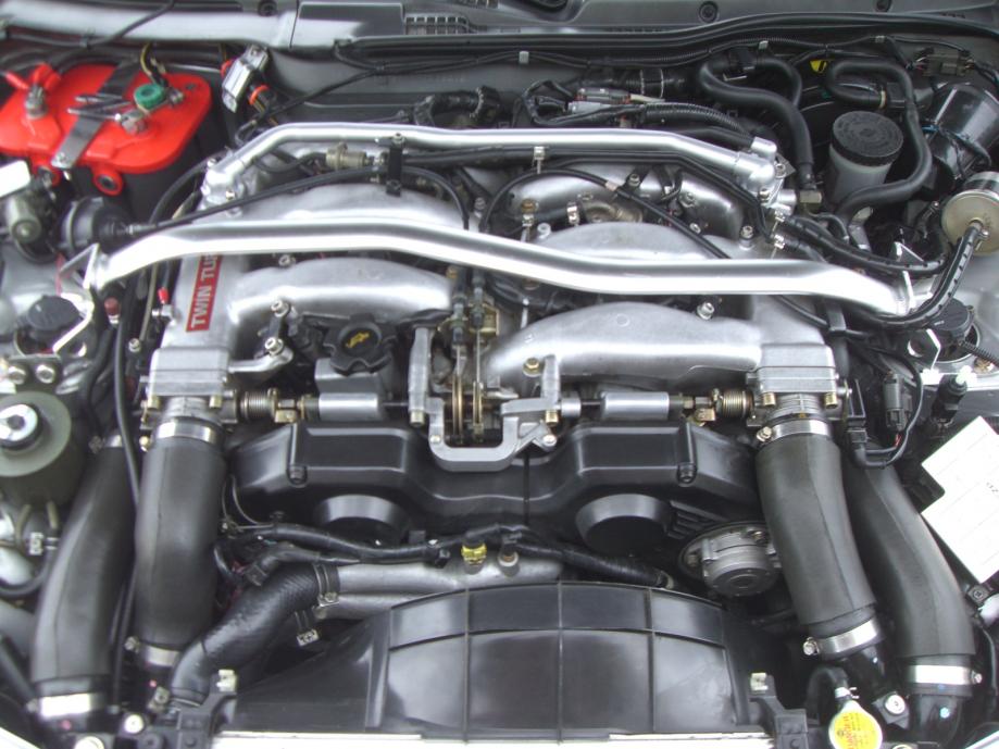

I don't think a STB would solve my cowl shake. The issue is body flex front to rear, caused by removing the roof structure. An STB will lock together the two shock towers to keep them from moving inboard/outboard. But that will do nothing for flex between the A-pillar and cross members behind the rear seat. I need a thicker trans tunnel and/or stronger rocker panel subframes.
BTW the material of choice for an STB application would be extruded aluminum. And it would have to closely follow the manifold profile. There isn't much airspace between the top of the plastic manifold and the engine blanket on the underside of the hood...er bonnet. I have the same fitment issues on the STB in my 300zx
