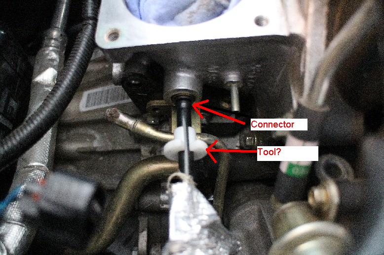

Gentlemen,
Well I'm stuck again. I'm still trying to get to those darn tunnel hoses. There is a connector I'm not sure how to remove. Is there an easier way? Do I have the right tool? I'm trying to follow the JTIS but sometimes it just says "remove the connector" This has been a real learning process and not always a good one. Every hose I touch crumbles and I'm pretty sure some of the plastic connectors are made from recycled sweet tarts. The parts list grows and I'm not half way there. I'm up to 20 hours and no end in sight.

You do not need a tool for this one. Spray a little WD-40 or silicone on the connection. Then press the black flange at the throttle body IN toward the throttle body. While pressing the flange IN, pull the tube OUT.

wow, that was easy and it didn't even break. THANK YOU!

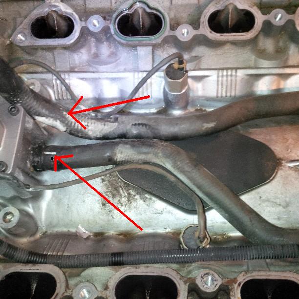

Thanks guys for all your help! I finally got it apart and I've never been so happy to find evidence of a leak in my life. Just have to order some more hoses and clips and she will going back together. I might even tackle the tensioners before spring. Yipee

Old Jan 20, 2014 | 01:09 PM
Likes: 17,018
Jeff,
You do superbly clear illustrative photos.
It has to go back together in a lot less than the 20 hours it took to strip it down!
