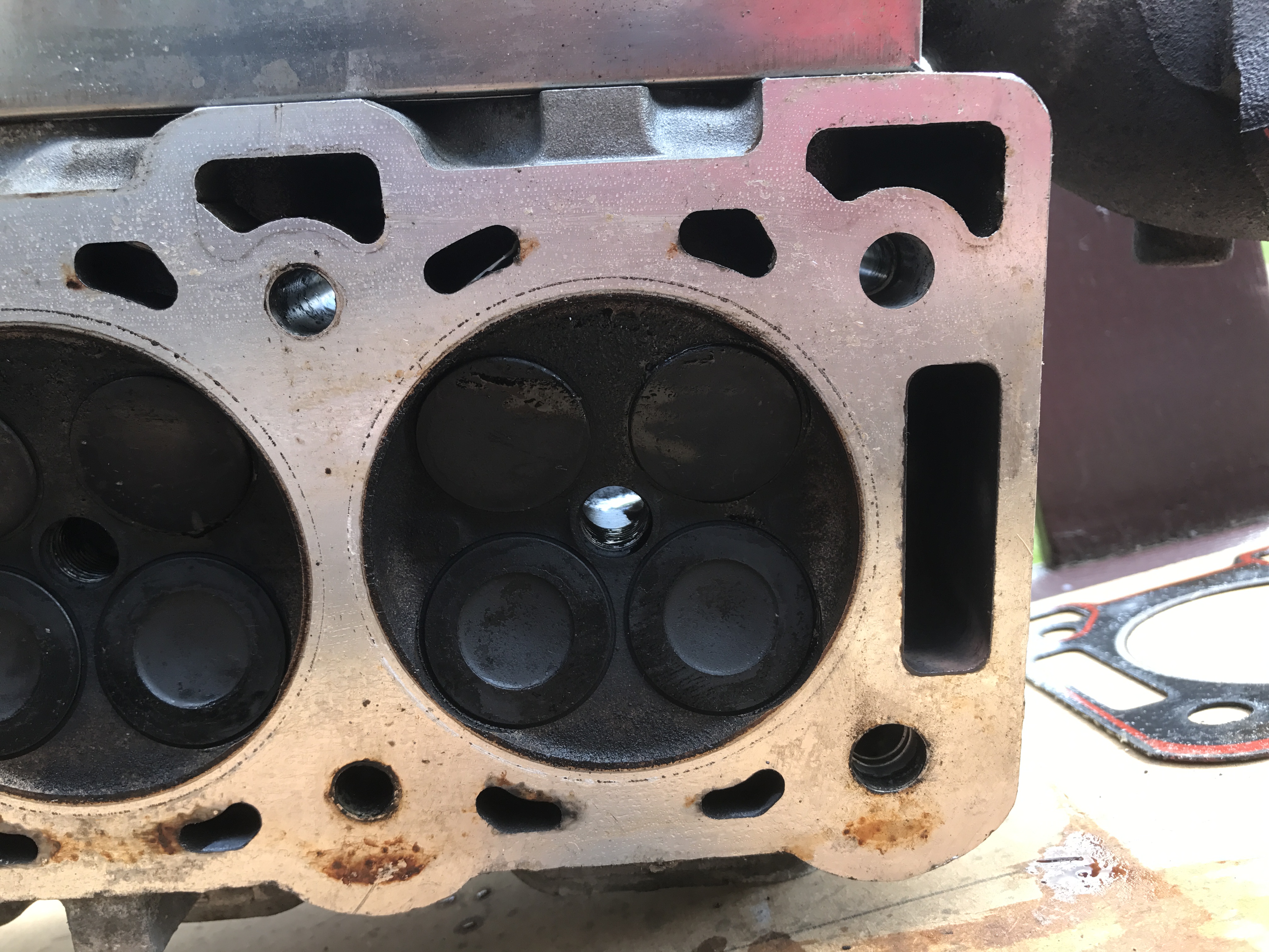

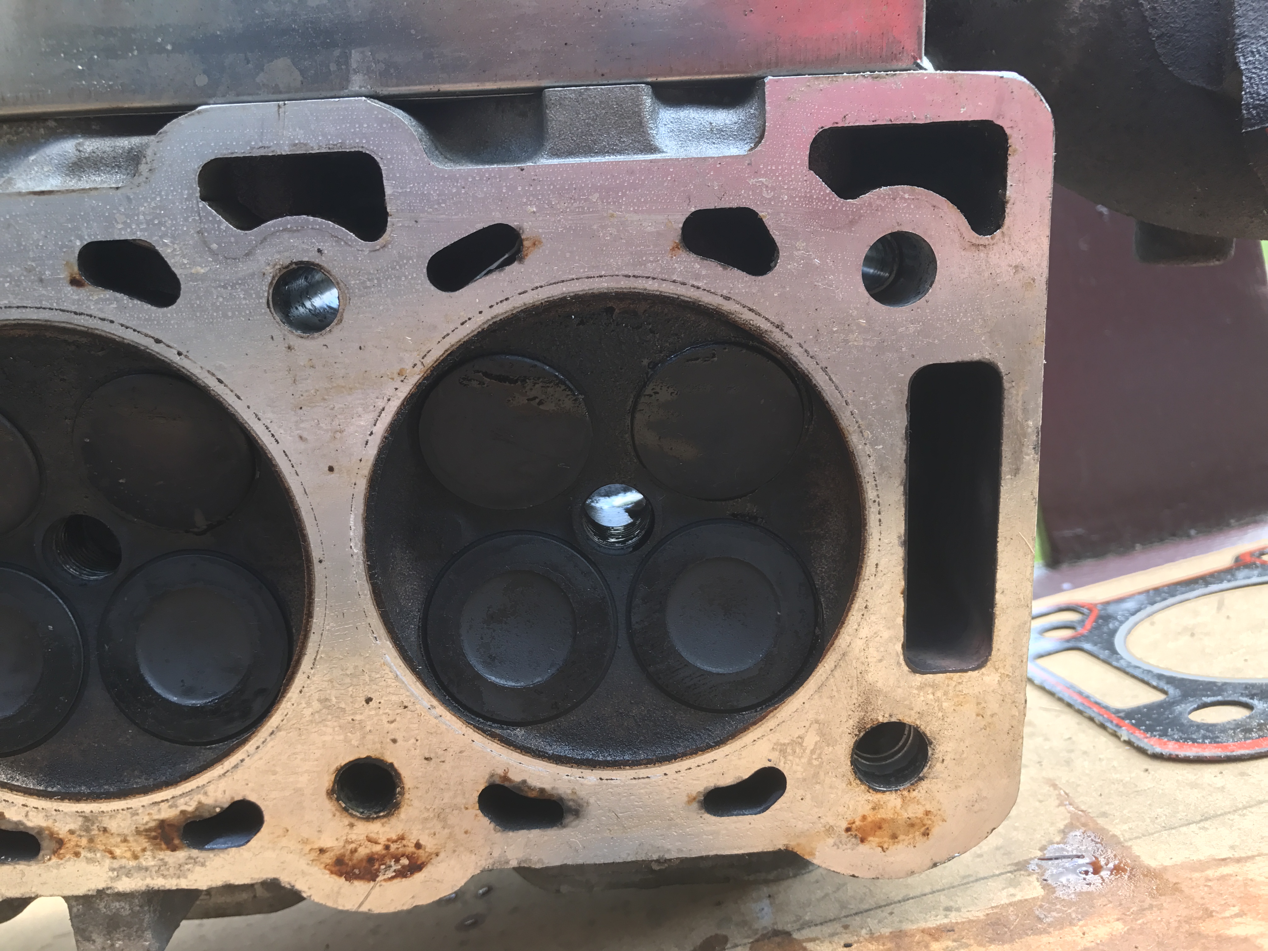

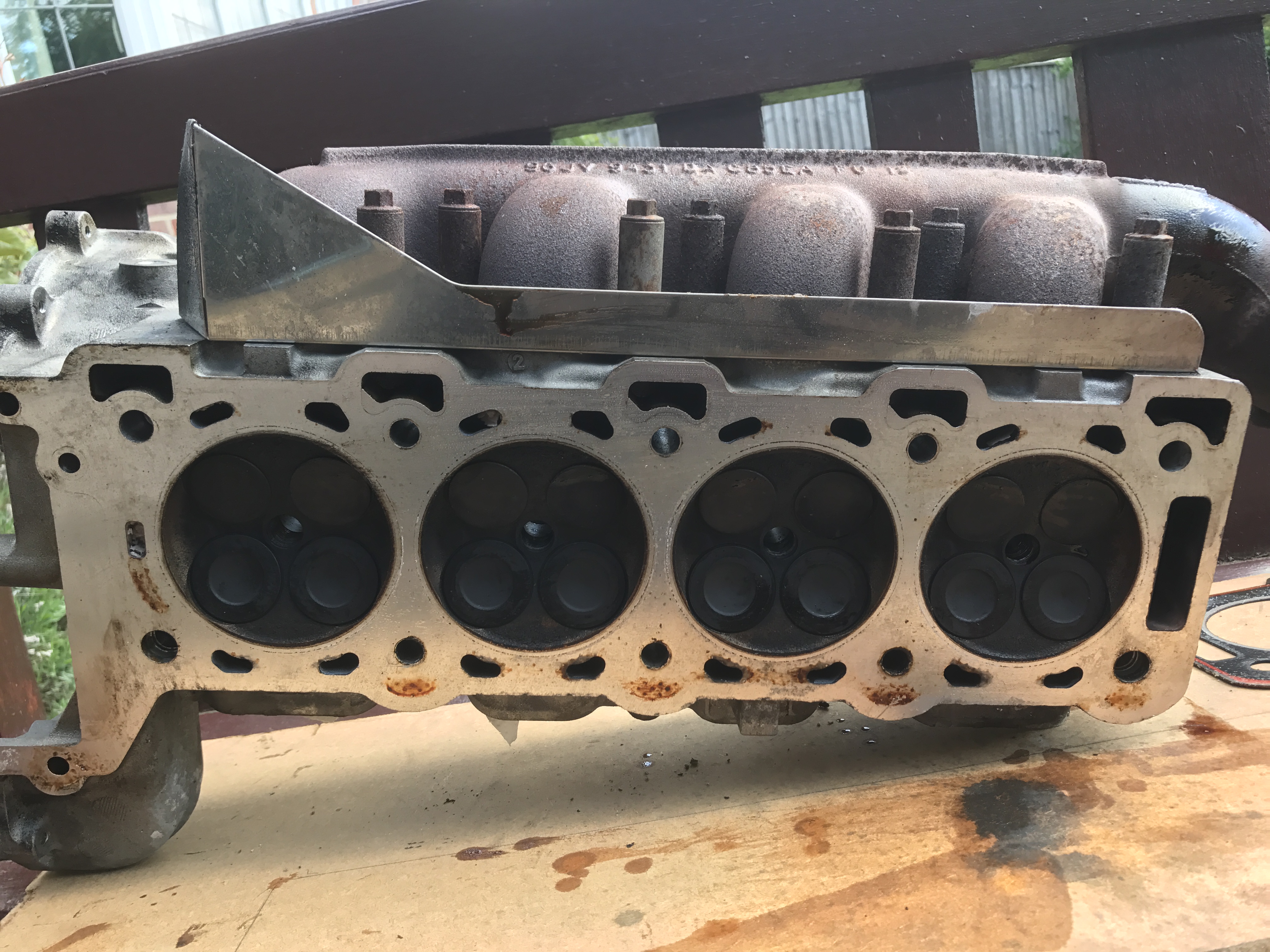

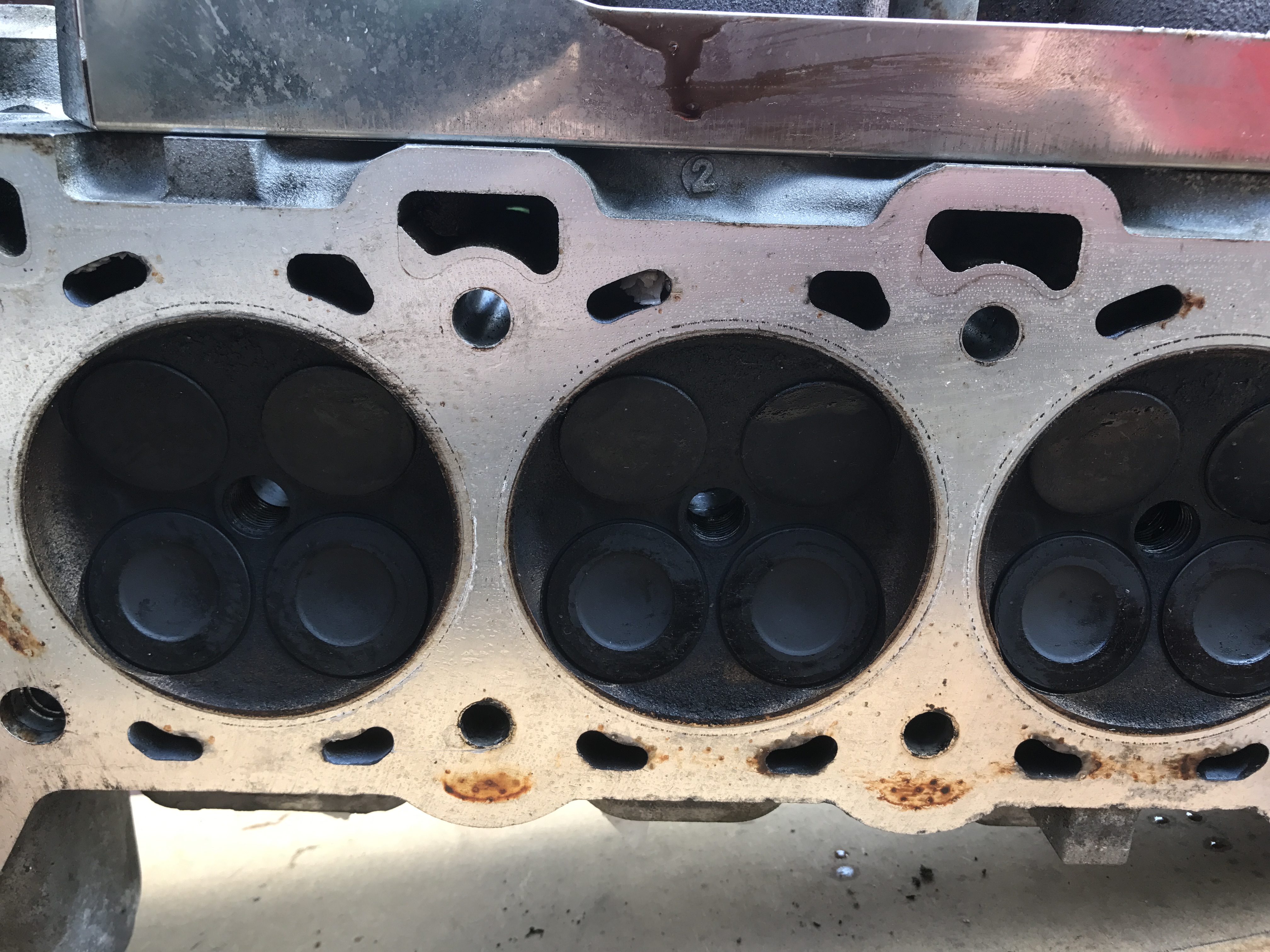

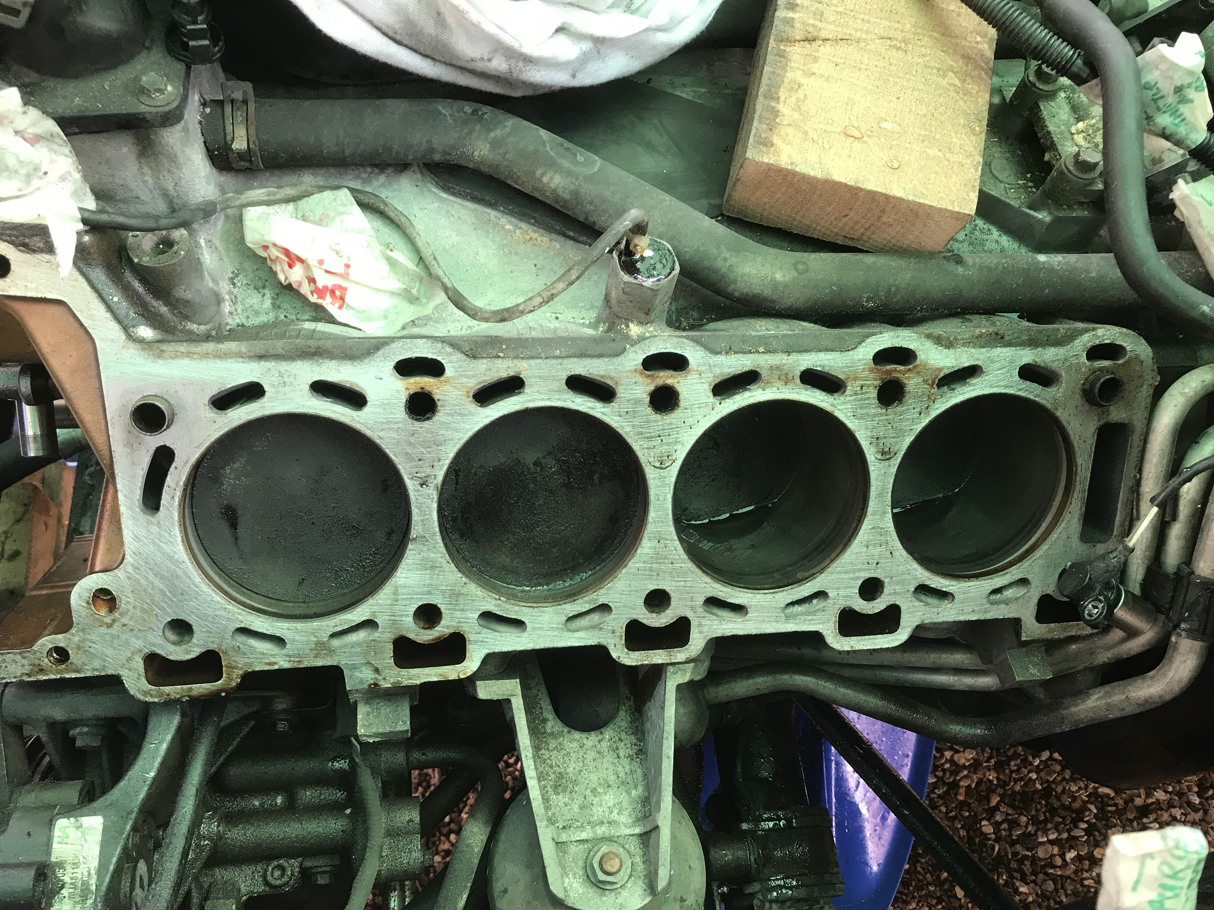

Default Head Job!
Straight out there this morning and yes indeed the bolts were still there.
The head was off in under five minutes once I took them out.
Doh!!
Thank you both Bob Roy and JBzXJ40.
So, this is the first head off.
My impression is that the last head gasket replacement was done pretty poorly.
The surface of the block is scratched and the gasket is not multi layered steel.
(Bob Roy, I will use MLS when I replace.)
However I do not see any very obvious area where it is blown.
Having trouble attaching photos, will try again.
Old 05-05-2017, 06:45 AM
martinrichard's Avatar
Join Date: Aug 2016
Location: High Wycombe
Posts: 45
Received 2 Likes on 2 Posts
Default Photos
Photos
Attached Thumbnails Stuck Cylinder Head-img_1607.jpg   Stuck Cylinder Head-img_1608.jpg   Stuck Cylinder Head-img_1609.jpg   Stuck Cylinder Head-img_1610.jpg   Stuck Cylinder Head-img_1611.jpg
Old 05-05-2017, 06:50 AM
Join Date: Aug 2016
Posts: 45
Default More Photos
More Photos
Attached Thumbnails Stuck Cylinder Head-img_1612.jpg   Stuck Cylinder Head-img_1613.jpg   Stuck Cylinder Head-img_1614.jpg   Stuck Cylinder Head-img_1615.jpg   Stuck Cylinder Head-img_1616.jpg

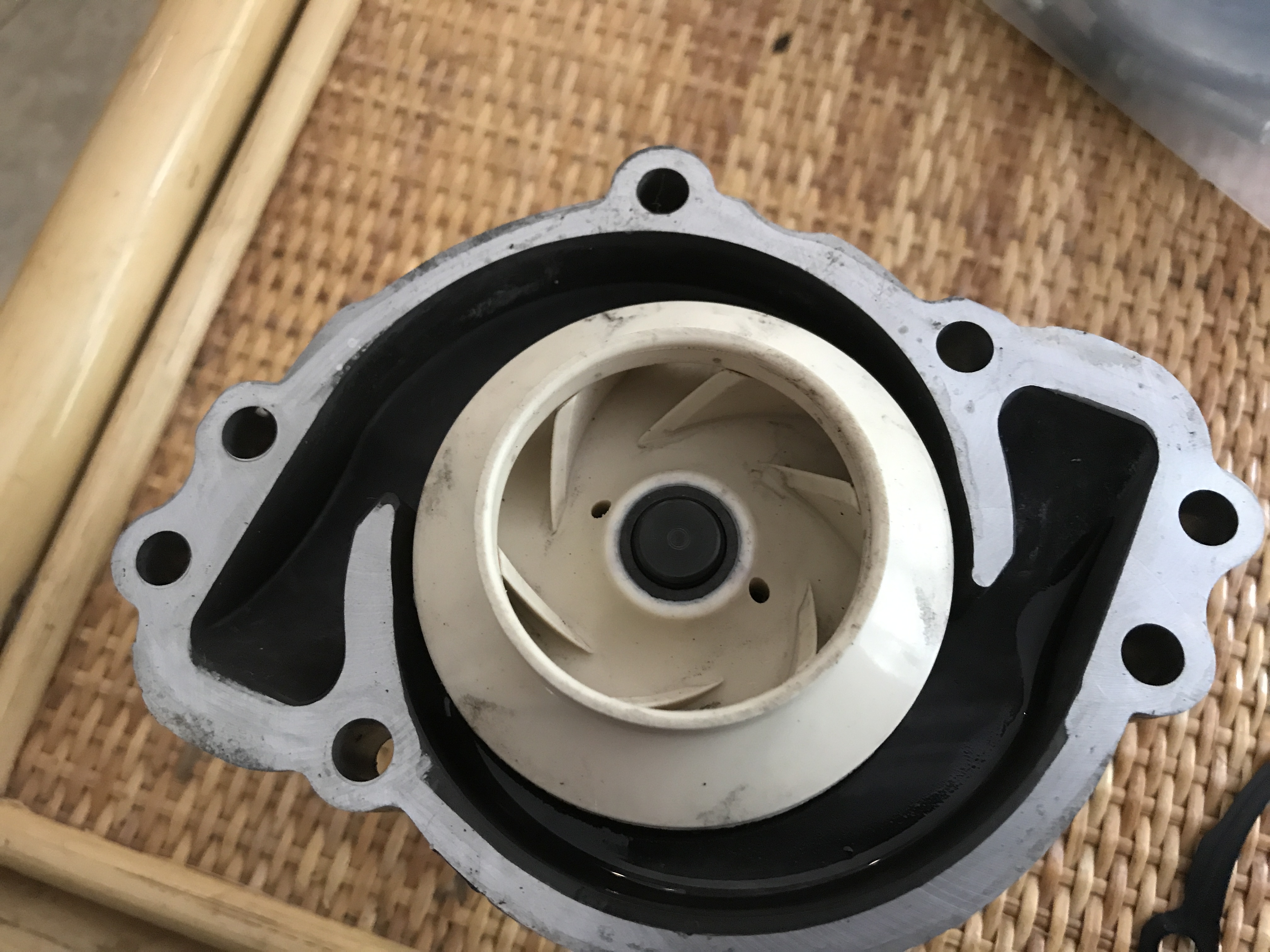

Check your water pump. The impellers are known to fail.

I've had that off and looked at the impellers which seem fine.
Noticed that it's a little stiff to turn and don't know how it should be.
Photo attached, I think it looks okay?
