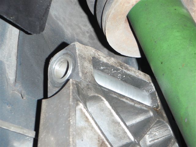

I found this picture
in this thread https://www.jaguarforums.com/forum/x...k-frame-12895/
There is also another member who has done this, Jono I think, however I think a second hand one would be a cheaper option, if you can get a good second hand one that is.

That's interesting, thanks a lot, if I still worked in a toolroom I'd do it myself.
I think you're probably right about the price being less for a secondhand one. I won't risk buying unseen as I've fallen for that before.
