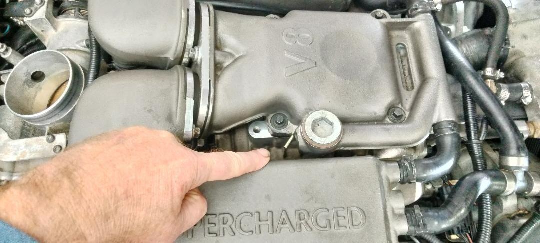

Unhappy Supercharger vacuum hose misplaced
Help, Supercharger vacuum hose misplaced. After installing new heater hoses under the super charger, I find I did not take enough photos. I have not located a vacuum diagram in my search. Where does the small vacuum port atop the supercharger outlet cover go. See attached pic. Thanks, Brent

I found the hose under the supercharger so I solved my problem. It probably goes to the valve on the intake elbow but I can't see exactly where. Anyone know how to delete this thread?

Fuel pressure regulator on fuel rail.
