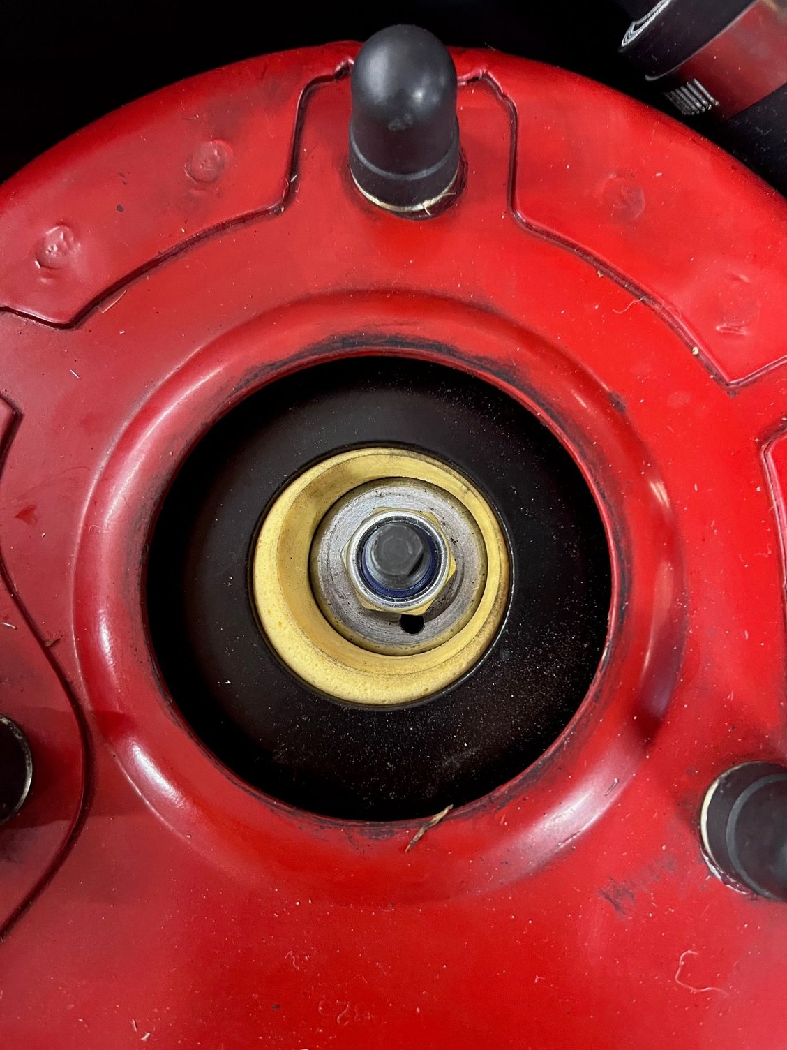

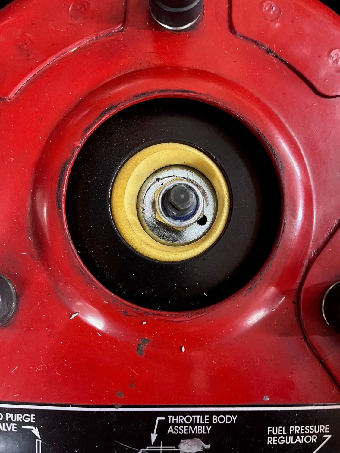

This is what I know has been done to it based on records, but more may have been done I'm not aware of (i.e. the shock mounts up front seem new - see photos)
86k miles - Stabilizer Bar Bushings
111k miles - Rear shock absorbers
As you can see the mounts up front are new, but no idea when that was done as it isn't documented.

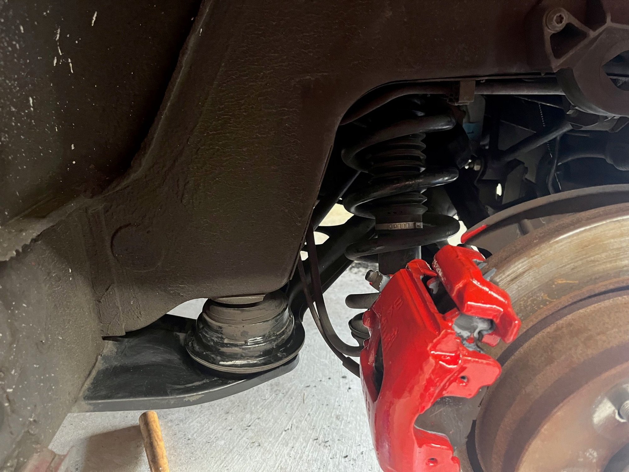

My suspension measured from the center of the wheel to the bottom of the wheel arches is:
Front: 14.5"
Rear: 15"
Based on what I've read that seems low, and everything points to that being the strut mounts up front, but again, they look pretty new (if off centered a bit).

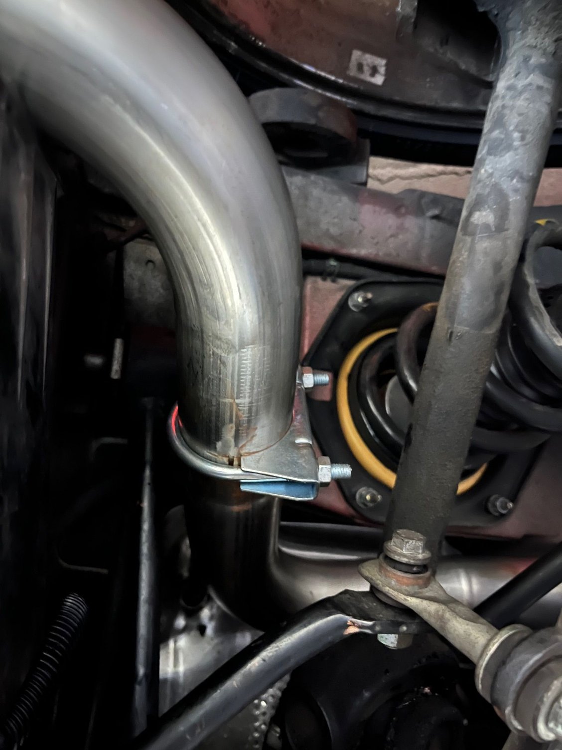

an aside...is the rear exhaust (shown) a mandrel bent (round) hoop over the rear axle?
wj
Yes, it's the Adamesh Stage 2 over axle, combined with the Adamesh Stage 1.
