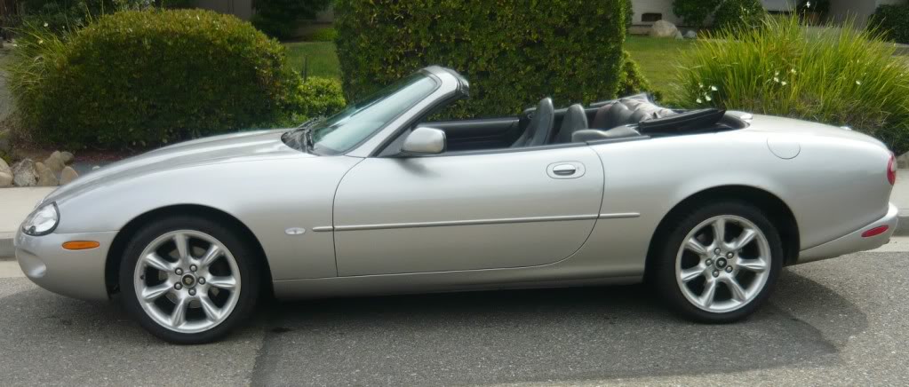

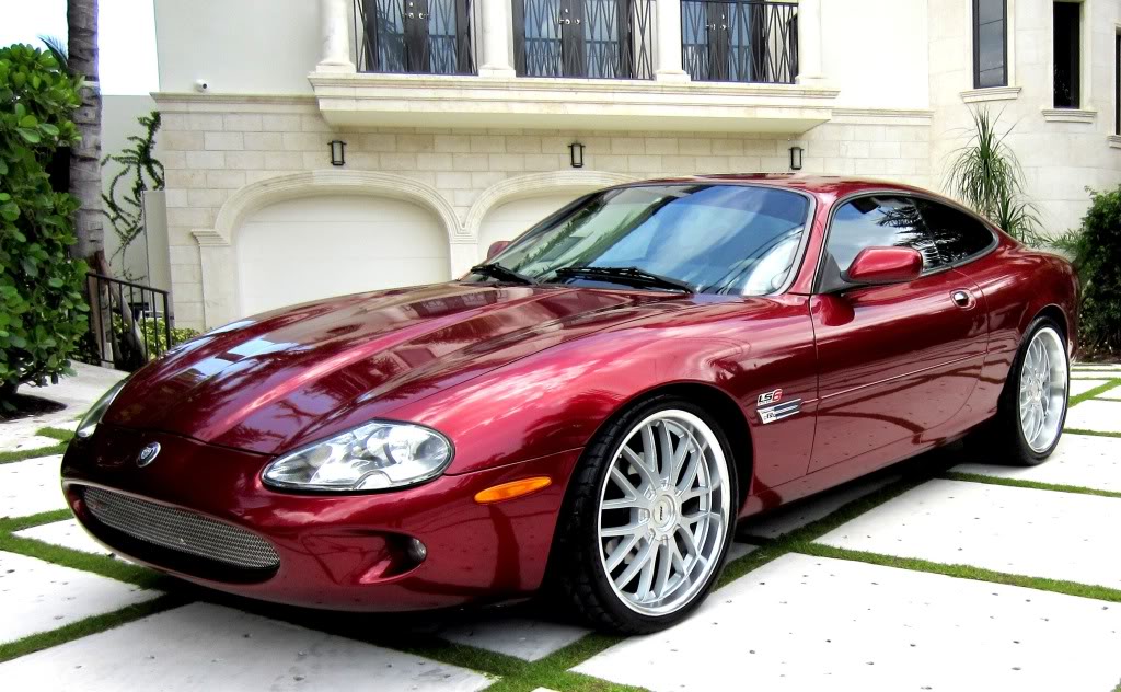

And to give you an idea of what is possible, here is a sample of XK8's converted using our kits/parts. Only the silver car was built by us- the other 2 were customer builds.
Thanks
Andrew
Jaguar Specialties
(This is my personal favorite- a 97 XK8 coupe with warmed over Corvette LS1- built by a customer in Florida)
And this is a 97 convertible built by another customer (Andre, who is often on this forum) using a 2002 Camaro LS1 and 6 speed manual trans (that's not a typo), The car has been up and running now for over a year....
