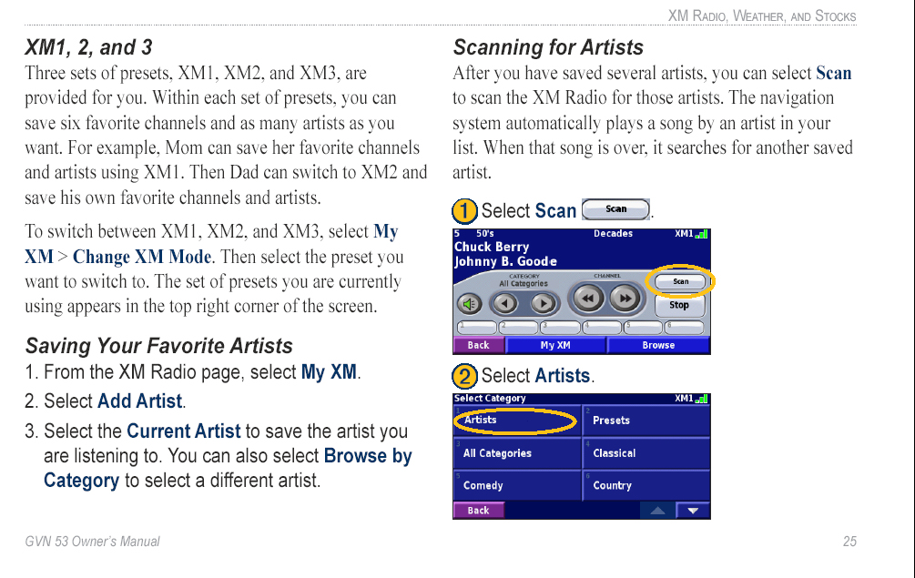

Did you know the GVN 53 also has a built-in XM satellite radio feature? Just need to add the optional XM antenna package for $170, and plug it in.
Here's a link to the full manual, in case you wanted to see what it is and how it works.

The GVN 53 looks awesome. I am ready to toss my $50 POS Sktfi3 XM radio which fails to start half the time, and install the GVN 53 navigation with XM receiver, PAC VCI-X switch and HKS CAMP 2 meter display.
It seems like a great integration and would turn that display from an albatross to something truly useful.
