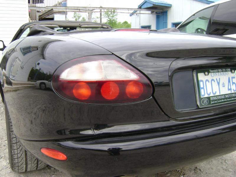

Hi All;
I was intrigued by K Westra's photoshop efforts, and decided to do some real-life experimenting. I just HAPPENED to have a spare, slightly damaged tail light assy on hand (Don't ask!) I went with the three-circle look, and applied a single coat of the black lens tint. I liked the look so much, that I bit the bullet, and modified both my rear lenses. The results are below (I hope). In real life, there is a bit more redishness to the affected areas, but it did get rid of the sort of 'red bug-eye' look that I wasn't crazy about in stock form. A night shot would reveal that I have hardly reduced the light that gets through when I hit the brakes.
Thanks to K W and all for the idea!

Sorry, Guys. My computing savvy has embarassed me again. I'll try and attach the pics again!
Attached Thumbnails Tail light minor modifications to update look-taillights-001-1024x768-.jpg   Tail light minor modifications to update look-taillights-002-1024x768-.jpg

Robert, that is exactly the look I'll be going for! Very nice! I don't think I will go quite as dark, but close, although it could just be the picture. Now that you've done it, I really need to bite the bullet and do it.
