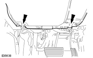

Slacken and remove the two screws securing the lower underscuttle to the fascia panel cross-member.
Withdraw the underscuttle upper fasteners from their locations in the fascia panel.
Position the underscuttle rearwards for access.

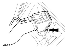

Disconnect harness multiplugs and reposition underscuttle.
  1.
    1. Disconnect air conditioning aspirator harness multiplug.
    2. Disconnect valet switch harness multiplug.

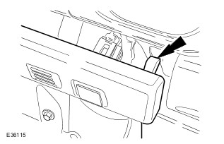

Remove stowage compartment lid.
  1.
    1. Position underscuttle for access.
    2. Slacken and remove two screws securing the stowage compartment lid to the underscuttle and remove the lid.

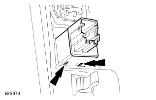

Release the valet switch securing tangs and remove the switch.

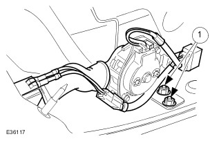

Remove air conditioning aspirator.
  1.
    1. Slacken and remove the two nuts securing the air conditioning aspirator mounting bracket to the vent and remove the aspirator.
Release the aspirator vent securing tangs and remove the vent from the underscuttle.
