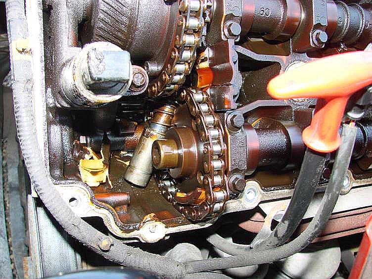

This can be the penalty of delay:
Old Feb 13, 2014 | 09:38 AM
Fulton's Avatar
Posts: 1,847
Likes: 696
From: Atlantic, Canada
Ouch Paul! I'm now sufficiently frightened and will get them swapped out before the spring when the Jag comes out of winter storage.
