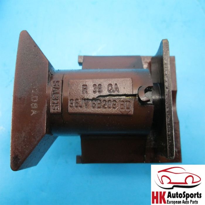

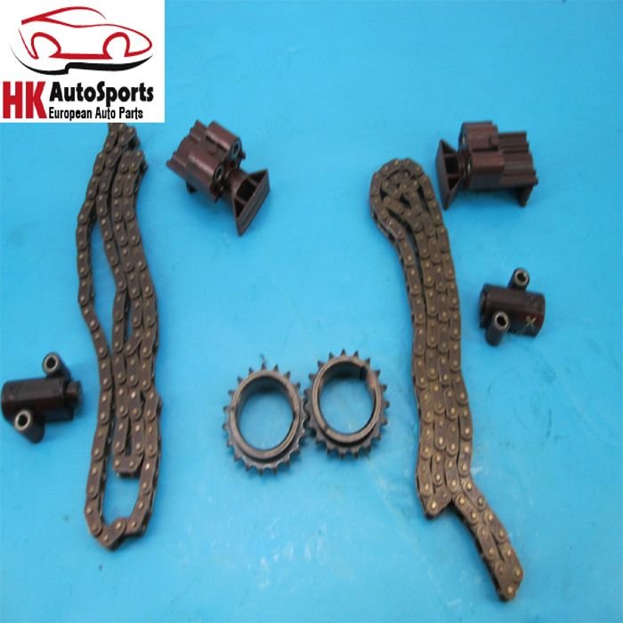

Originally Posted by test point
Looks like there's even a market for your old tensioners over there -
Timing Chain Kit w Crankshaft Sprockets Belt Tensioners XJ8 XK8 1999 | eBay
"PLASTIC PIECES HAVE SMALL CRACKS"
Sounds like a bargain
Incredible!
I'll let my broken tensioners go for $25 Canadian, and if you pick them up I'll throw in a beer.
