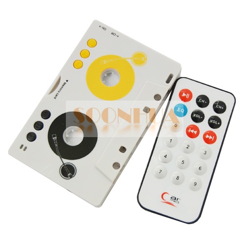

Here is what I use. It is not sophisticated, but it is cheap. I can swap my SD cards between cars. No Wires, and it does not use my power outlet.
Just another option....
Attached Thumbnails Is there not a simple aux-in adaptor for the stock stereo head unit?-casette.jpg
Looks interesting, can you give more information please.

The MP3 Player Tape Cassette Adapter for SD/MMC Reader that I show in the picture is really an MP3 player. It has a slot for an SD card (I have a Micro SD card with a SD converter) and you put your mp3's on the card like a normal MP3 player. It can be used as a standalone mp3 player, since it has a volume control, and a earphone output jack. I have a bunch of 2 and 8Gb MicroSD cards with all my music.
The downsides of this player.
1. It has a battery that needs to be charged. (Comes with a USB cable) Battery lasts a few hours. I would guess about 5.
2. It plays the MP3 files in the order they were added. No random play option.
3. You cannot use the cassette controls on the head unit. Comes with a remote!
The quality depends mostly on the quality of your MP3 file (the higher kbs of the file the better the quality. 320kbs is very good, 128kbs is stretching it - you can hear distortions) and your speakers. My speakers in the '98 is not perfect, but when the top is down, it does not really matter to me.
At under $20, I like it and it solves my problem. (I got mine off Ebay) I also have a FM Modulator/MP3 player that uses SD cards, but that uses the power outlet, which I don't like, and the FM transmitters do not work well in areas with lots of stations.
Just my 2c..
This sounds like a good option for those wanting to keep the stock look, I would question the sound quality but it does tick a few boxes
