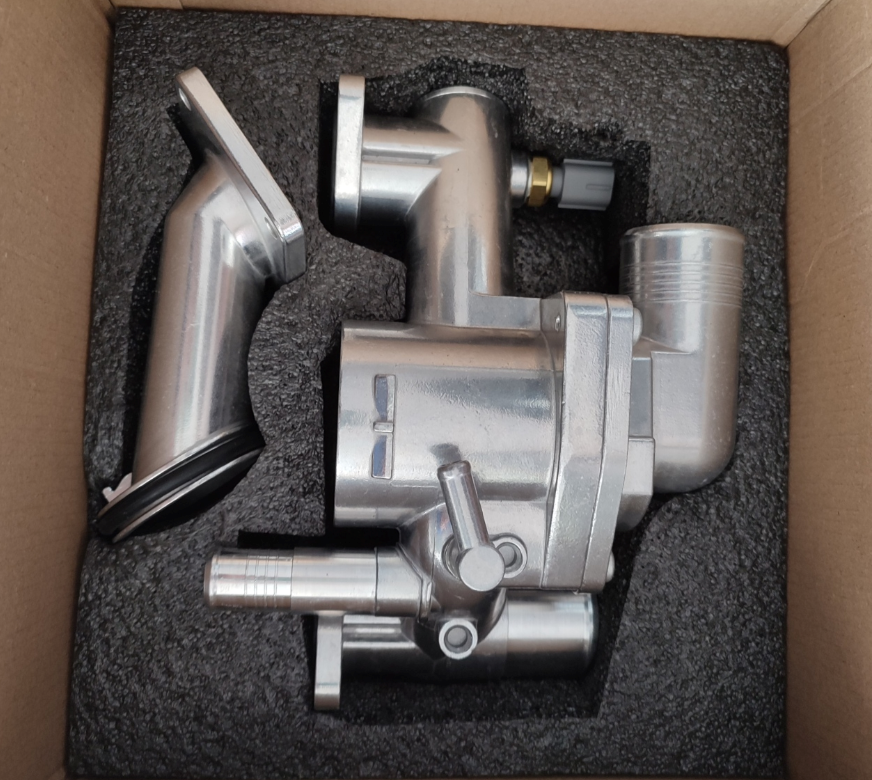

I found them on eBay and AliExpress. I installed one recently, it's still working, and then I bought another as a spare. I also saw an aluminum housing and bought it out of curiosity. One question: do all the 4.2 engines from that era use the same thermostat housing, whether they're S-type, XK8, or XJ8?

I've noticed the thermostat housings aren't the same. They're slightly different for the XK8 and the S-Type. Here's what I just received from Mitzone via eBay for the XK8.
