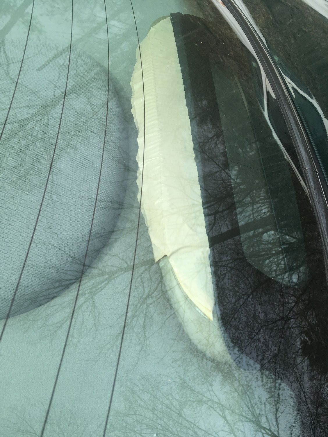

I hear ya! My XK8 coupe (1998 in BRG) has a third brake light that is loose (clips broken) and looks like crap (previous owner tried to remedy with tape).
I will keep looking on ebay (no luck for a month) but SNG Barratt offers the cover part it seems and only in black (not SDZ cashmere). LJA5003ABXXX for $158.
But it is primed and ready for paint so this seems to be the only option.

I'd love to see photos of any fixes done. Thanks!
