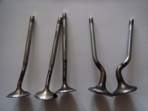

It depends on how deep you want to dive: I would do both primaries and secondaries, although it's the latter that are the engine-killers. Do a search on 'zip-tie method' for the easy route to address them.

Under the time previous owner of my 2002 XKR there was a failure of the tensioners at about 115,500 miles. It cost him $5,000 to hafe it fixed, which included the upgraded coolant pump.
That is just one demonstration of the necessity to get the work done before a failure happens. It’s much much cheaper before the failure to address the issue.
Although it’s been posted here that the 2002’s have the latest tensions installed at the factory, using my car as an example, I’m thinking that depends on the engine build date.
