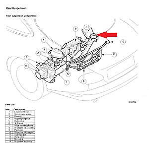

I've deleted you other identical thread from X150 forum. As you've discovered, this is the correct place to post technical questions about your model.
There's several possible sources on the rear suspension. In addition to shock bushings, the 'A' Frame bushes are a regular fail:
As a general rule, where I find a bush/bearing failing on one side, I replace both sides as preventative maintenance.
