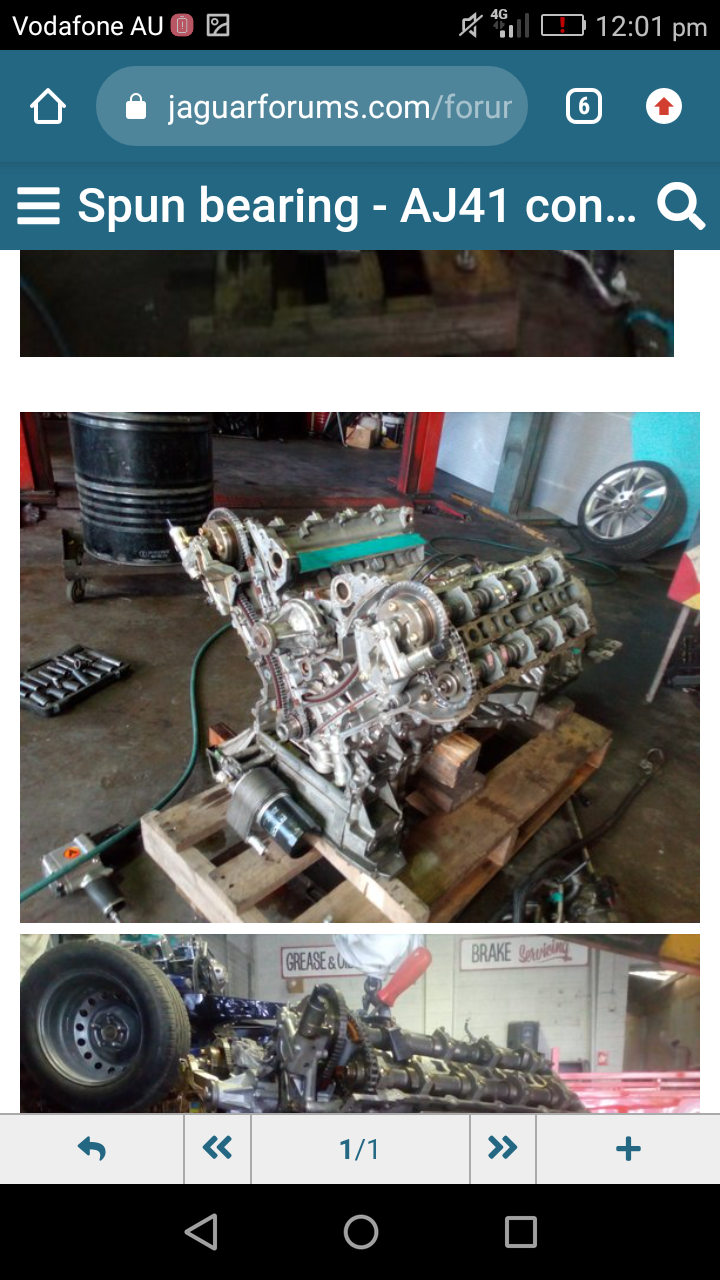

Pan off , sump off and discovered movement on rod #6 . at this stage I was hoping no damage to crank and I could simply swap out the upper and lower bearing haha no luck crank journal completely scored ..ouch .
So if you get a chance get it on the lift first and have a good listen for rod knock if your lucky you might have caught it in time and yes you can swap out con rod bearings from underneath providing your crankshaft is not damaged.
Also go OEM on guides and tensioner I bought a kit for over 500$ USD and ended up buying OEM guides and crank seals as the quality just wasn't there
