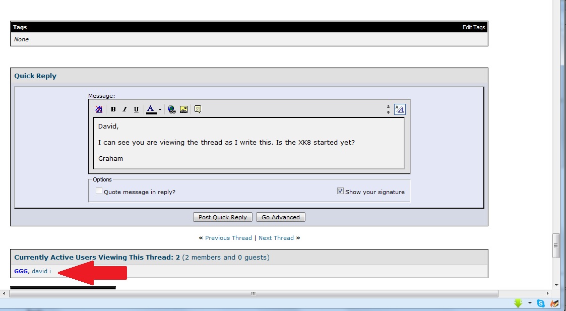

Old Apr 15, 2014 | 02:30 AM
David,
I can see you are viewing the thread as I write this. Is the XK8 started yet?
