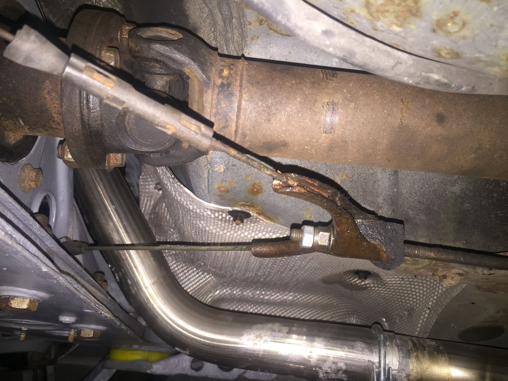

Wondertechy,
When you consider Jaguars own limits about Towing in Neutral (below from owners Manual), then agree that disconnecting the Prop-to-Diff bolts is your best option. Ensure that no part of the prop-shaft is resting on the cables beneath otherwise it will potentially apply the parking brake shoes !
