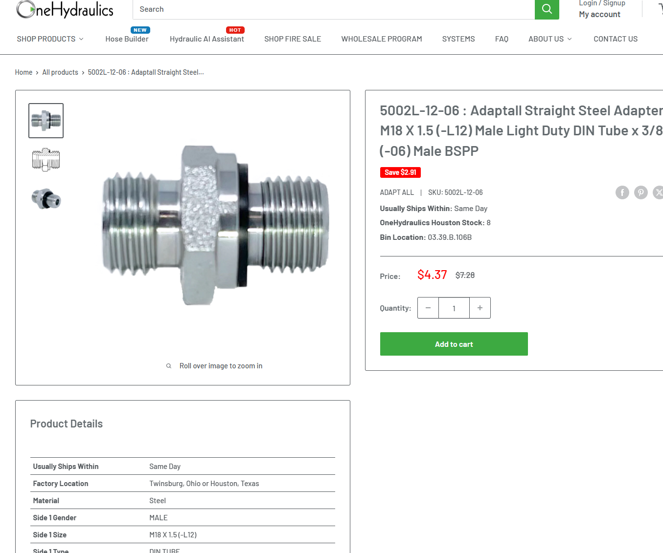

Does anyone know the thread size on the plug that goes into the ZF trans fill hole? I would like to give it some thought and a shot... I've looked at some of the photos of the thing, there has to be a way.
Which trans? From the ZF documentation, 5HP is Screw Plug M18x1.5 (part # 0636 308 025). 6HP appears to be the same.

From MIKE (what up man,,,, long long time!) the 5HP is Screw Plug M18x1.5 (part # 0636 308 025)... From that a M18x1.5 compression fitting is easy and cheap. Measuring and welding the pipe with an elbow aint bad... I think this might be doable.
