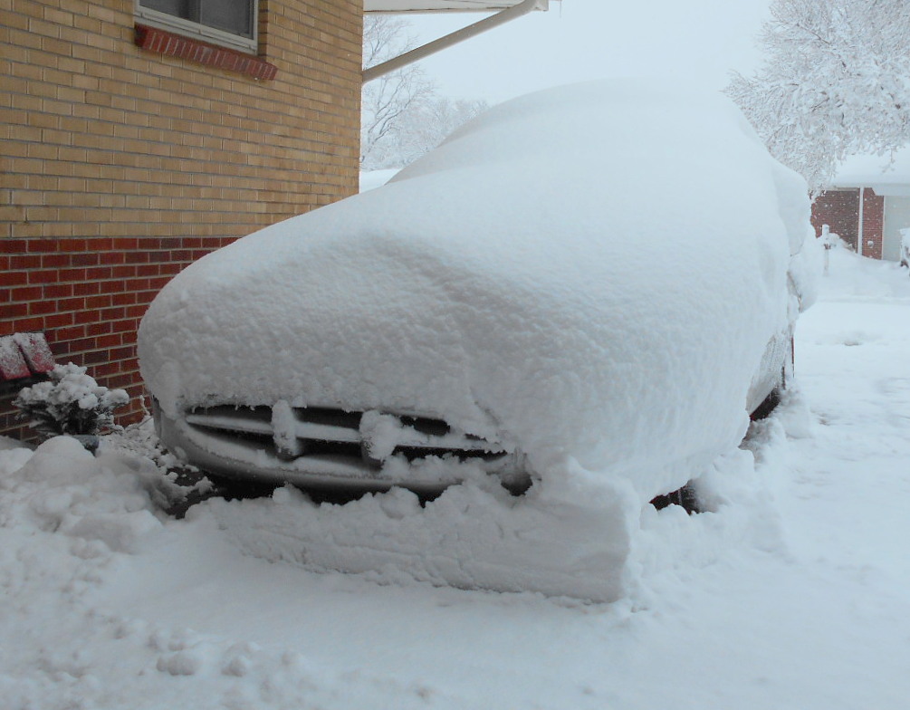

My 99 XK8 has been shifting funny occasionally. I stop briefly and when I step on the gas, the engine revs up a bit before 1st gear engages making for a neck-snapping start.
Today it did this shifting into reverse and again when I went to drive. I suspect low tranny fluid, but it seems there's no way to check this. Any one have a similar issue?
Attached Thumbnails The Transmission DipStick for XJ8 and XK8 is Available-sno-cat-1-2016-mar.jpg
