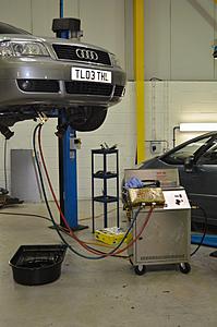

It's not a DIY procedure .....
..... some expensive kit required.
