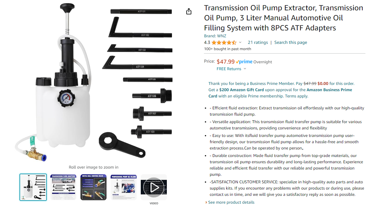

For the DIY-ers here, something like this is mandatory for servicing these transmissions. I'll post the link below. This allows you to pump the fluid into the fill hole and minimize burns in the process.
Amazon Amazon

A small hand-held siphon pump from Harbor Freight also does the job quite well. Typically less than $8....
